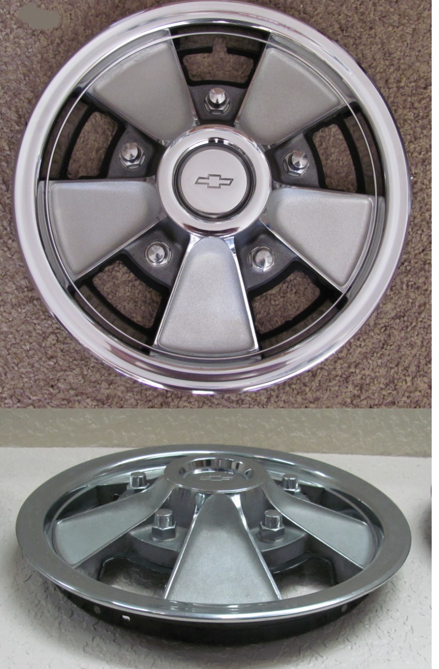

I'm looking for a picture of the correct 1967 application of the Factory Chevrolet Mag Wheel style wheel cover/hub cap. Some had a black inlay in the spokes and others silver...

Here ya go...
Black spokes came later, '68 or '69??

I'm not sure when they started the black "spokes". I've got some, but was never sure about the application. Most of the black ones I've seen seem to be 15", but I have seen a few 14s. Maybe the 14s were painted after by an owner?

The 2 part numbers of the covers are;
3963434 black spokes. indicates late 1969
3903086 as illustrated above are 1967 thru 1969
Information from Wiki 7/1/1969

One of many common mistakes I see. Guys with beautiful 66 SS Chevelles with the 67 SS Simulated Mag Wheel Covers on the car. and Vice Versa
Note the arrows pointing to the difference on 66 vs the other photo of 67. Both 14 inch.
