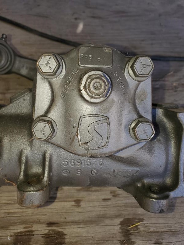

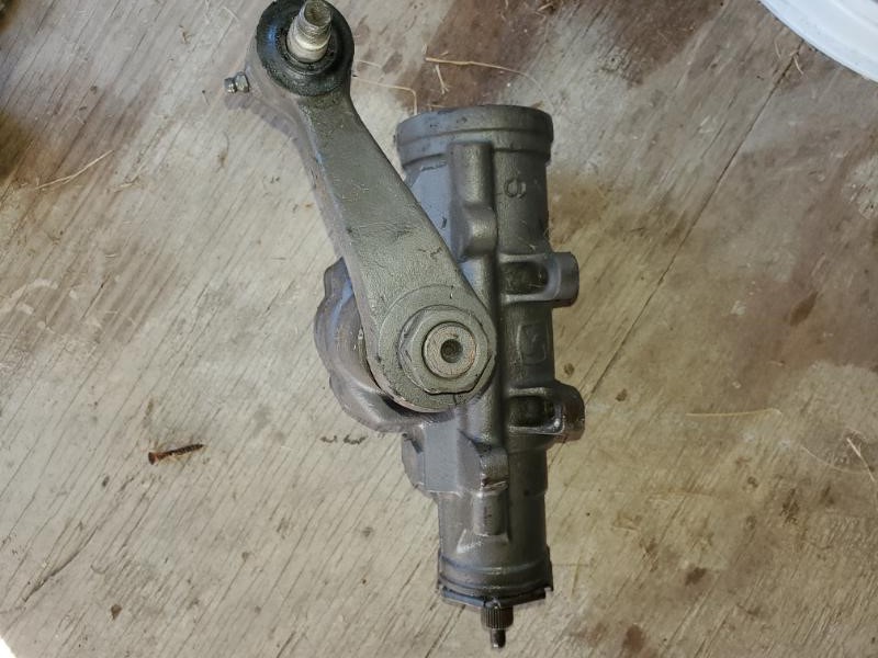

I have this

nice piece but wrong date thanks for posting Still looking not much out there

Can you tell what the year is it could be a 8 or a 0

Looks like a 0 anyone else see a 0
