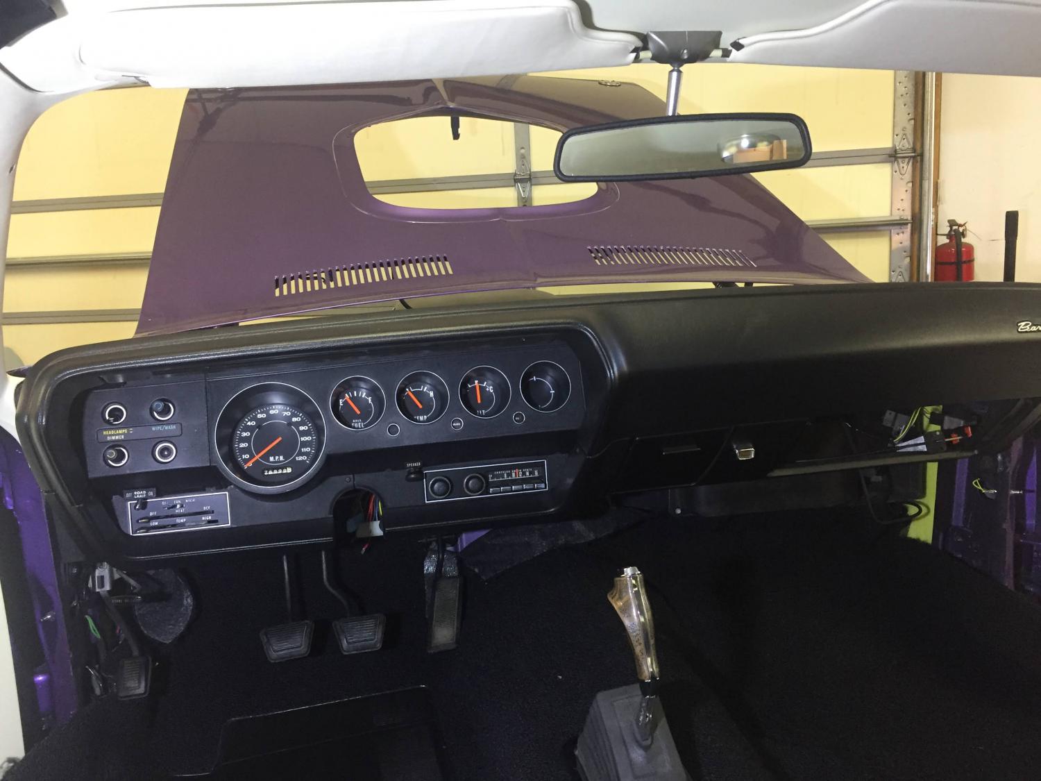

I had been working on cleaning and repainting all the gauges, dash moldings, brackets, and the dash frame itself over the past week. The dash frame is painted in a unique suede black finish that takes some patience to apply properly - I.E., you really have to stand back and spray it dry, out of the can for it to come out right.
This morning, with the help of my son, we got the dash assembly installed. It took all of one minute. You just engage the lower forked bracket onto the two kick panel bolts, then hinge the whole assembly up toward the cowl, insert the four screws in the defroster duct area, and it's done.
I then started installing the carpet. It really has to be shoved up forward under the dash for the molded area to properly engage with the shifter hump and to get the cutout in the heal pad to properly aligned with sheet metal kick-out of the driver's side kick panel,where the dimmer switch goes. Now I am in search of original carpet photos to see how the factory trimmed the carpet up under the dash where it engages with the gas pedal, steering column, heater box, etc. Anyone got any E-body under-dash survivor photos?

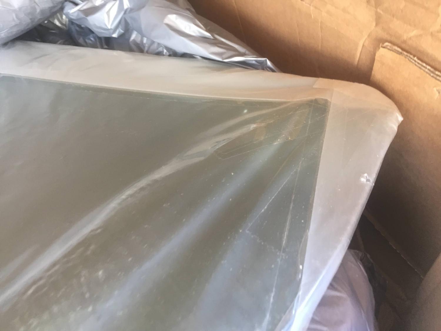

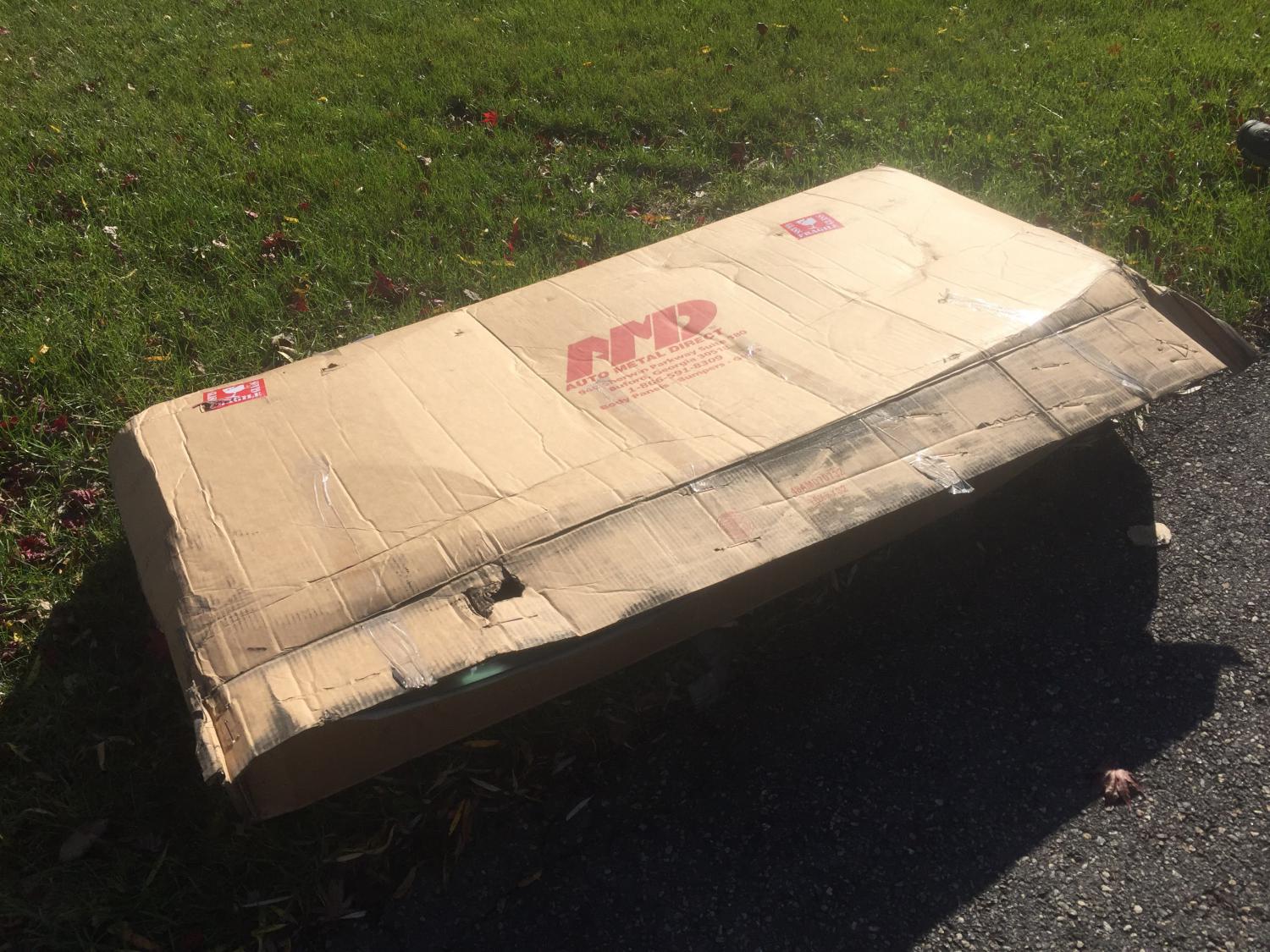

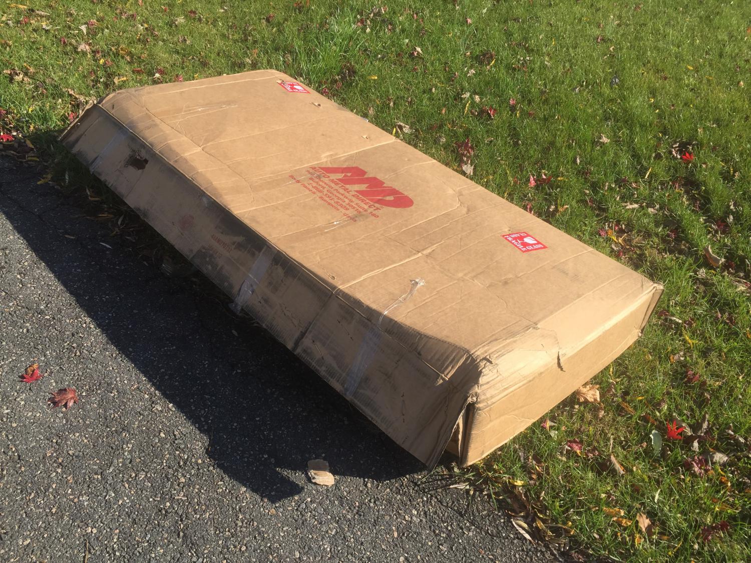

Well the shipping gremlins have struck again. I ordered a new AMD windshield from Jegs...and the shipping depot "lost" it for 6 days.
They attempted to deliver it today.
Flimsy carboard box.
Box was open completely on one side, with four pieces of broken tape that had been placed over the flaps.
Forklift tire tread marks on the open side flap.
Three pieces of styrofoam for padding.
Loose in the open box.
Chips all along the edges where it had been dragged on the ground.
I refused the shipment.
The problem is that this is how AMD ships glass. (and sheetmetal, as you may recall from our previous episode with the trunk lid(s) shipped from AMD)
Jegs customer service has been great. They refunded me my truck shipping charges and ordered me a new one with instructions to AMD to actually package the glass as if it was made of...
...wait for it...
...GLASS!
