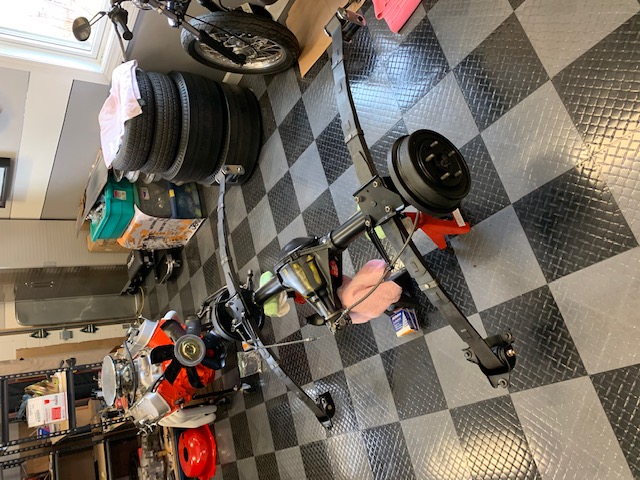

After seeing a few unrestored cars, they were pressed in from the driver’s side, so that’s what I ended up doing. Thanks guys for the input. 👍

Benny's car would be a good one to check.

Wow, everything is so clean and new.
Did you put the front mount clips and bolts on just to keep track of them ?
