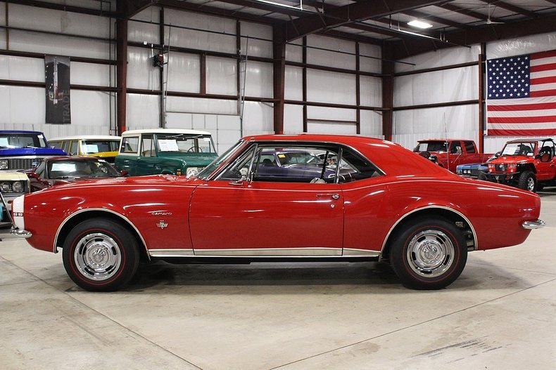

This the ride height of my car.

I ran 15x8's and L60's on my 69 without air shocks and factory multi leafs. 67and 68's should be less of a problem. I think they had 4 inch backspacing.

15x8's on a L60/275 tire fit nice on a 67/68 but I prefer a 15x7 rim with the same tire because it bulges the side wall of the tire for a little more period look. if I could only figure out how to post pics ? I have tons on my phone I could share

The tallest I would run for skinnies on the front is a 6.40.15 tire. The smaller 25" tires look disproportionate IMHO and the larger ones at 28" tend to over stuff the wheel opening. If you plan to run it on the street and want to retain that natural stance with stock wheel opening reveal, then look to the 26.5" to 27" front tire sizes. https://www.cokertire.com/tires/640-...blackwall.html
On the back, I agree with Jeff that a 15"x7" is best for the wheels. Any 60 series tire in the 27-28" height range is going to look best, and the L60 Goodyear's are probably a good place to start looking. Kelsey Tire are the makers of vintage Goodyear and have lot of tire selections on their website. Coker also has some decent choices, but it all depends on the look you are after, and the type of driving you plan to be doing. Just keep in mind that these are not your typical highway cruising radial tire and require you to pay attention when driving.

My cars ride height as about like your red car, maybe a little higher in rear. No air shocks or front mods. I run 15x4 in front with a smaller tire and never have rub issues. Sometimes you have to give a little on appearance to make things work,if you drive your car.
15x8 reverses in rear and I have to watch about getting it in a twist or they’ll rub on occasion .I’ll PM you the tire size I have later.
