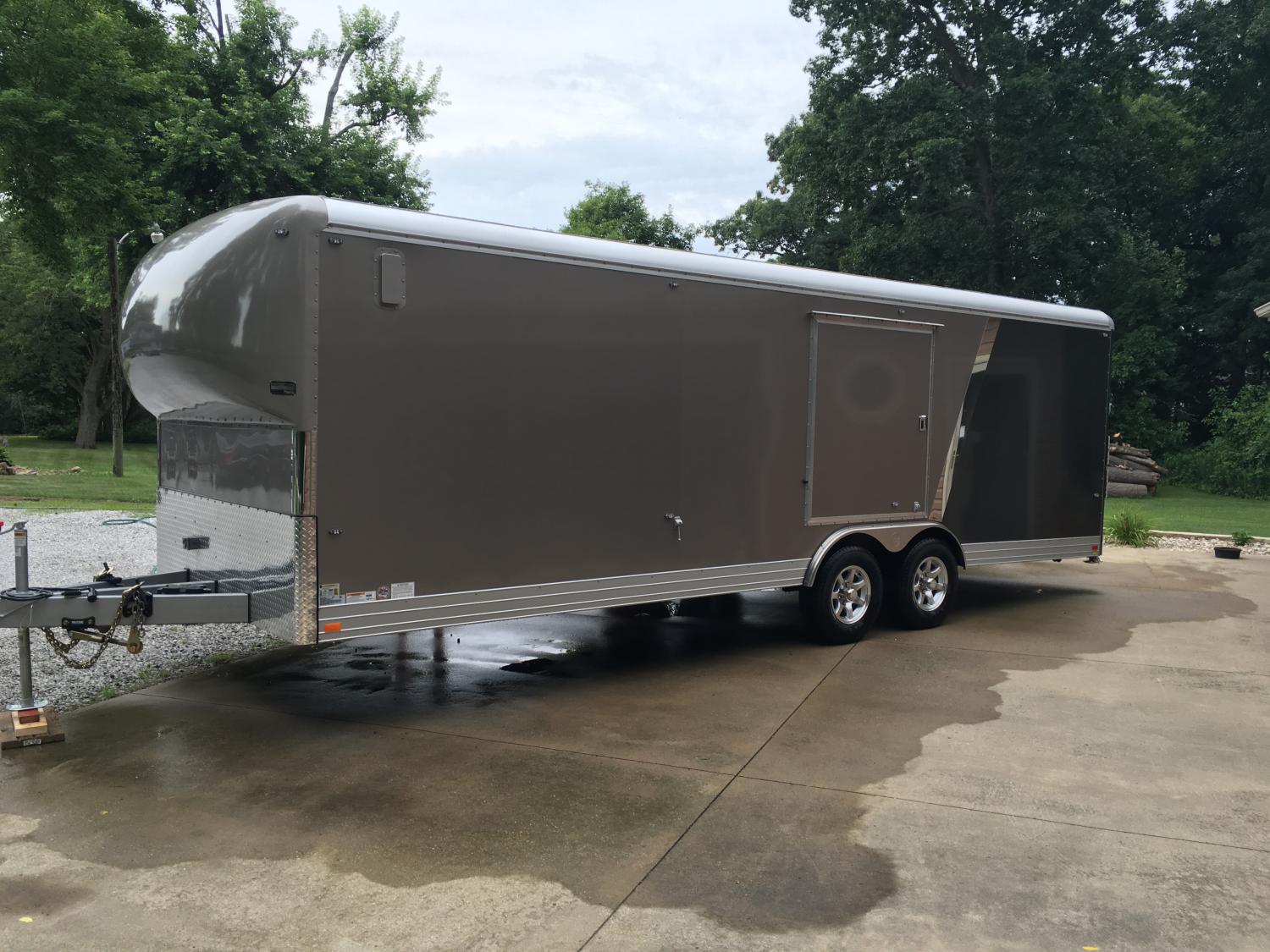

I am back in the market for an enclosed car trailer. That poses a question, what is your preference between steel and aluminum frames?
I had an enclosed Featherlite some years ago, and the trailer checked all the boxes for me. I recently had a conversation with Graeme, and he prefers a steel frame.
Naturally, the aluminum is lighter.......but comes at a cost.
I don't see having the trailer out in the winter elements, nor do I need something short of a condominium. Do you have a brand preference?
I'm sure some of you guys put on some real miles as well have a defined opinion of a quality unit.
I appreciate your consideration,
Tim
