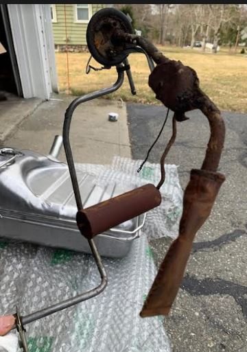

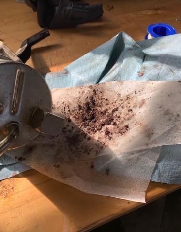

So the 1976 Formula discussed is in the garage though a couple of "gremlins" as expected with a low mileage rarely driven car. After some investigation of the tank and fuel filter, I determined the old fuel in the car in addition to moisture had caused quite a bit of erosion in the tank. It was disclosed that the car needed a sending unit (also pointed out by a member) so had planned on doing a cleanse on the fuel system anyway so not surprised. At this point, I have a new tank, sending unit, fuel pump, filter and back lines just about completed, waiting for a tank vent line (something related to emissions for that year). I will make sure the lines from the tank to the pump are tended to as well.

I ended up getting the tank and related parts at Ames Performance in NH, great outfit. The sending unit is below, you can imagine what the inside of the tank looks like.....
Worth mentioning, the seller offered to pay for all parts and my time to address the problems though I declined knowing that he had been clear that the fuel was old and the car was running in a manner that would not indicate a big problem. Interestingly enough, the issue started ONLY after I introduced new ethanol fuel to the old fuel.

Agree on the carb approach, it appears new as the seller had it rebuilt by El Camino John (I honestly don't know who that is) but I assume it is someone he knows that has a name in the hobby. The tank was a mess, the fuel pump was not great BUT the fuel filter at the carb was surprisingly not bad. Regardless, that will be my last step to ensure a clean system.

The sending unit in my 900 mile 74 Z looked at least that bad and I saved it with media blasting, carb cleaner etc.

Thank you Charley, I will retain the OE and keep "in stock" once I get it refreshed. Appreciate the share on the condition of yours, makes me feel a little better.
