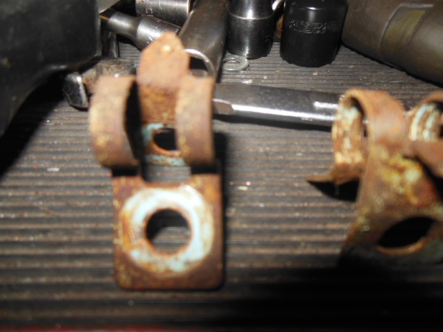

working on a sept of 68 build 69 Camaro and never seen this style of clip it has the open top and the color is a robin egg blue are these correct ?

My 10B of 68 LA Z28 has those clips on the fuel line.

my cars build date is 4th week of sept I guess I will have to restore these

ALLZS, is you car a Norwood or LA car?

norwood

This is on my 69 convertible 11D build date Norwood car

I found the same on my 10D early built 69 Z28...
I just ended up mixing some light blue and dipping the clips...
