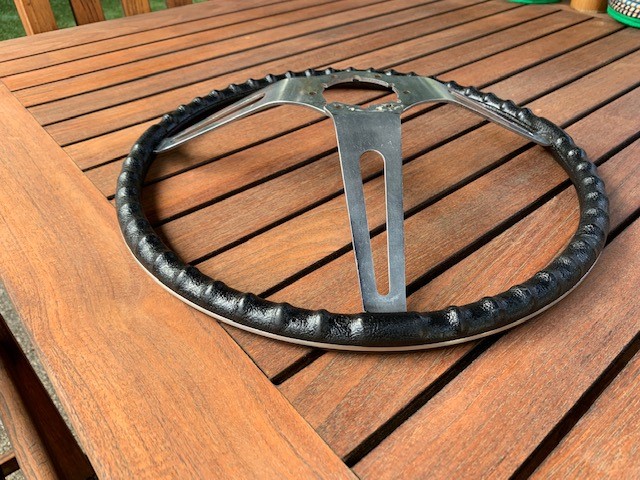

Hi all.
I picked up this Cushion Rim wheel locally recently and am unsure of the "F" stamping. Can someone enlighten me?
TIA.
1969 SS 396/350 Chevelle
Old 01-29-2020, 03:57 AM
Kurt S Kurt S is offline
Location: Ann Arbor, MI
Posts: 3,156
Thanked 922 Times in 401 Posts
NK1 wheel. http://www.camaros.org/swheel.shtml#misc
F is either the vendor or the mold ID.

Thanks Kurt.
Yes Bill, it is in reasonable shape for it's age. Pretty sticky when I got it, as they can be. Wiped it over with some brake clean and it's good to go.
