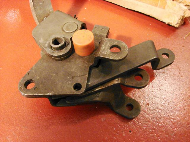

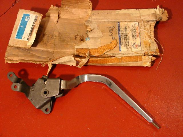

I have a very nice 1967 Camaro shifter that was pulled from a gorgeous California survivor RS/SS maybe 20 years ago. Wasn't my idea, but a college friend of mine decided he was done with the stock shifter and gave me this one in a box. I came across it last weekend and was surprised to see the stick is not stamped 'Muncie.' This car was/is a #s 295hp 350 Super Sport with its original Muncie (and this I personally verified, when I rebuilt it for him after he blew the driveshaft out of it and took part of the tailhousing with it).
I'm contemplating selling the shifter but I don't know if an unstamped handle could be considered correct in '67. I've searched around but the results seem pretty inconclusive. Any feedback would be appreciated.

Usually its the cars with Saginaw transmissions that have the unstamped handles as you probably know. Will be interesting to see what you can find out.

Addressed here: http://www.camaros.org/shifters.shtml#sag

I was told by Chevy Dealership mechanics that if a customer had trouble shifting the dealer would try adjusting the shifter rods but if they still had trouble shifting the dealer would install a replacement shifter.
There was a service replacement part number that was just the shifter with no rods or other parts.
I had a few of these NOS replacement shifters over the years
If someone had one of these replacement shifters installed , they may not have always got one with the MUNCIE stamp
