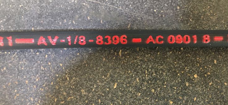

Here is my first attempt at stenciling the rear brake hose on my '68 Camaro. Not perfect and I think there's room for improvement but it's a start!

I had issues doing this using paint before and on Grady's Red COPO I switched to a acrylic ink, worked great, took several light coats applied with a Badger airbrush. Used the same ink for the tank stencil, tape pulled off clean.

What type of stencil tape did you use, Mike? I have a vinyl sign cutter machine available and want to try this. I tried having a custom stamp made and couldn't get enough color saturation. I have an airbrush and would like to try with a stencil.

Reviving this thread again, does anyone have a lead for sourcing the stencils that Mike posted photos of above?
