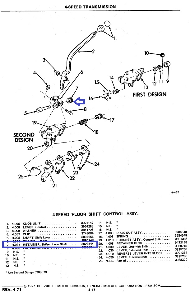

A guy posted in my club about this too and shared a link about this Retainer which carries the GM part number 3923544 here,
https://www.camaros.net/forums/27-tr...-retainer.html
  #16
Old 11-10-2019, 02:07 AM
XXXGoldL34M20's Avatar
Join Date: Dec 2009
Location: Great White North
Posts: 4,082
Thanks: 132
Number 7 Shift Lever Shaft Retainer 3923544

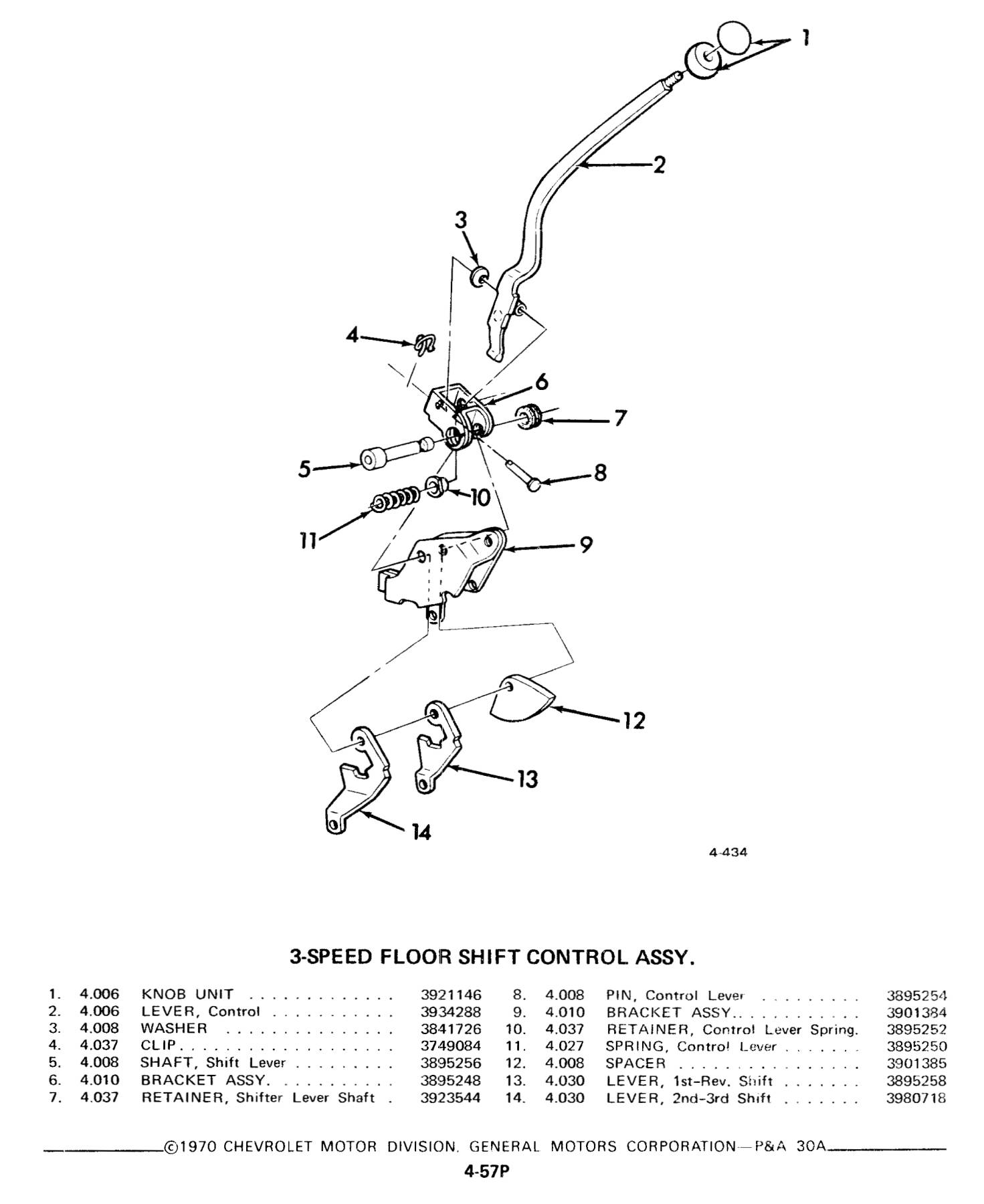

That drawing shows the replacement of the new style reverse detent with the old style.
On that drawing , they don't show the neutral gate spring or what Chevy called " the control lever spring" .
I have been trying to find the original drawing that just shows the original style reverse detent to see if the neutral gate spring is shown.
The 3 speed Muncie shifter drawing shows the neutral gate spring
This caused a problem.
I did a Muncie shifter for a 68 Camaro that went for judging at the Camaro nationals and they told the owner that the 67-68 Camaro 4 speed did not have a neutral gate spring. The 3 speed did have it but the 4 speed didn't have it and they used that drawing as evidence.
The same basic design 3 and 4 speed Muncie shifter was used in 67-68 Camaros, 68 to 72 Chevelle , 68 to 72 Impala , and 68 to 72 Nova
I had many original shifters that had the neutral gate spring but some were missing them but other parts go missing on the used shifters also.
I talked with the Camaro judges on it and sent pictures of original unrestored shifters with the neutral gate spring and they sent me a picture of a NOS shifter without the spring. They stand by the rule that the 67-68 Camaro 4 speed did not have a neutral gate spring.
I stand by my findings that they should have the spring.
Most shifters use a neutral gate spring including the Hurst shifters and most of the cars and trucks that I have seen have one. Some cars don't have one though.

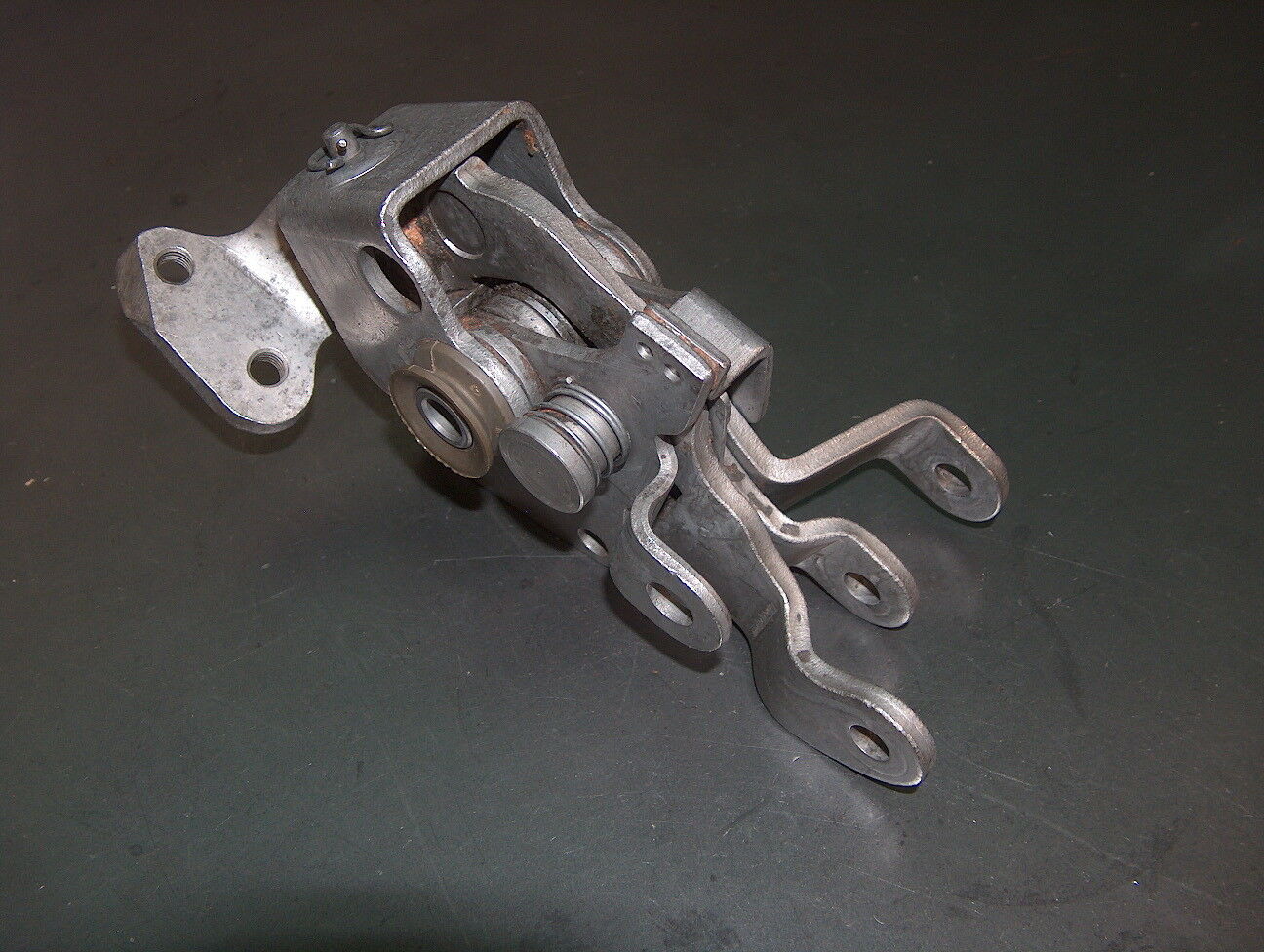

A couple of close up photos showing a take off from a 1970 Chevelle Muncie.
Shows the Shift Lever Shaft Retainer 3923544 really well
