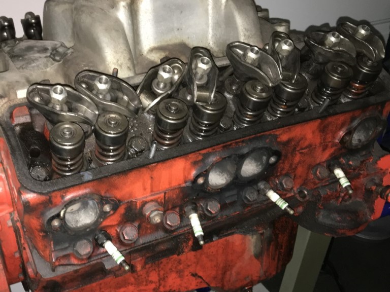

Default What cam would you run in a day 2 69 Z28
Title says it all
Stock 302,
Headers,
Wide ratio and 3.73
Do not wanna loose the Z28 character
I have the 140 in the car now - its too much for a driver
