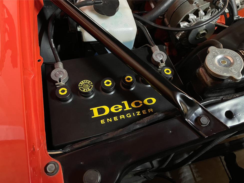

I assume you're talking about the Y-55's because I don't ever recall a Y-59. So yes the Y-55's are yellow and are less cranking amps. They are also reverse polarity (as they call them here) with the terminals reversed and would technically be a correct battery for a SB 69 Camaro for instance. Negative is closest to the radiator and where the hole is found on the core support for the little ground wire to attach off the negative cable.

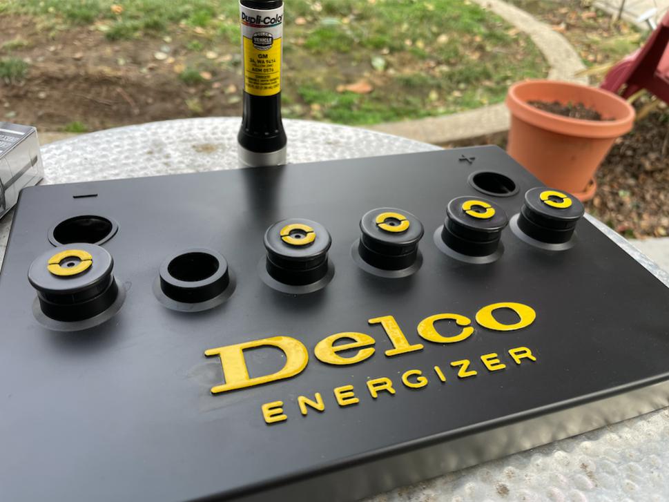

I've always had a correct battery in our Z with the terminals reversed (technically the R59 wouldn't work anyway unless I modified the original battery cables because the ground wire to the core support isn't long enough to reach from the other side of the battery), so I just recently made my own Y-55 topper as there are none produced at this time. I started with an R-59 topper and switched the polarity insignia. My wife found a place that sold the correct decal that even came with a warranty card that I thought was funny. I painted the yellow accents myself even though the kit came with yellow decals. Pretty happy with the results.

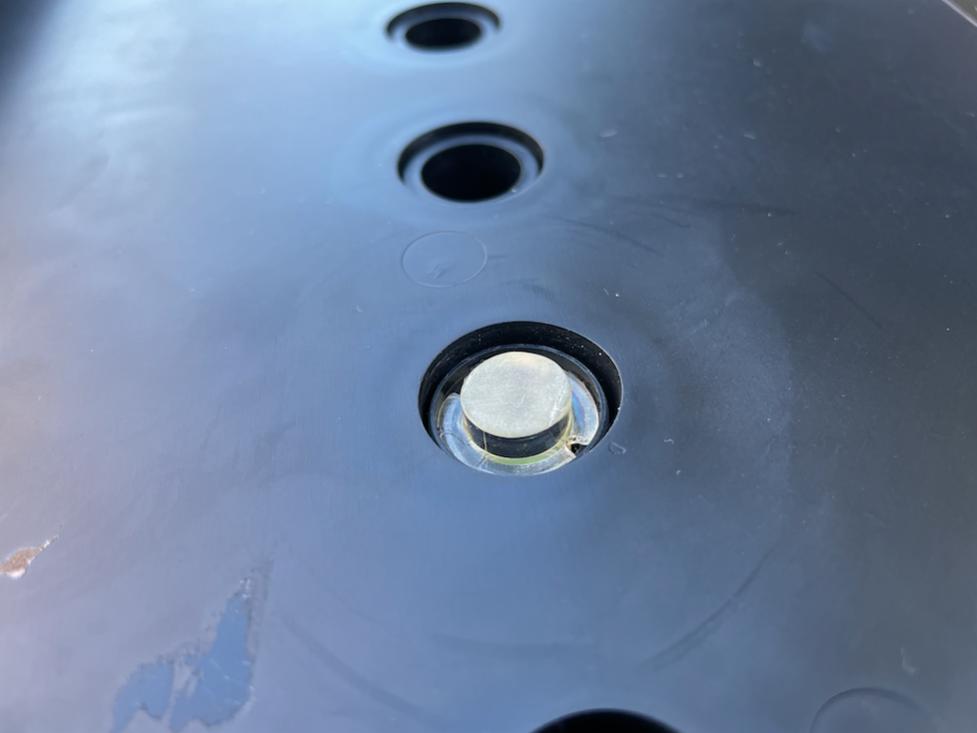

I'm in the process of modifying an R59 battery topper. It's really not a big deal to me because I'm not trying to score 100 points at a judged event but I've not been able to find out what color the Delco Eye should be!! In modifying the topper I've drilled out the Eye and replaced it with a length of acrylic rod. I'll be able to show any color I want through it. Even though I had an R59 in the car when I bought it (brand new in '69!) I still can't remember what color it was. Any thoughts??

I put Green Painters tape under mine, I simply bought a NOS Delco Eye cut it down and popped it in.
