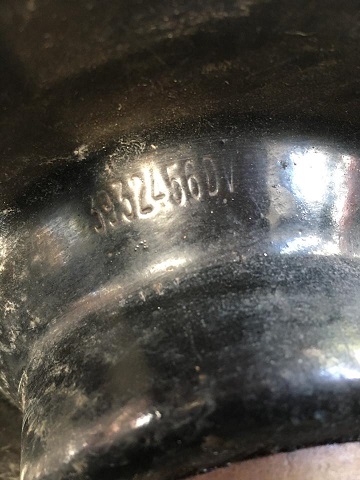

Looking to purchase this 1969 Z/28 … Would like some help with the Pad stampings and the Cowl tag please. Do they look correct and original? ANY help would be appreciated
Thanks in advance for your help.

The tag is perfect... NO PROBLEMS
I would not want to make the call on the engine stamp because the BROACH PAD NEEDS TO BE CLEANED WITH lacquer thinner before a LEGITIMATE determination can be made.

Ditto what James said

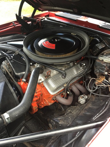

Am I seeing things or is there a crack in the cylinder head and looks close to the push rod. Not sure if it's just the picture, Or I'm just seeing things.

yes sure looks like a crack

Yes it does look like a crack ….. This car runs amazing too.

Looks like a hair to me.
Jason
X2...
