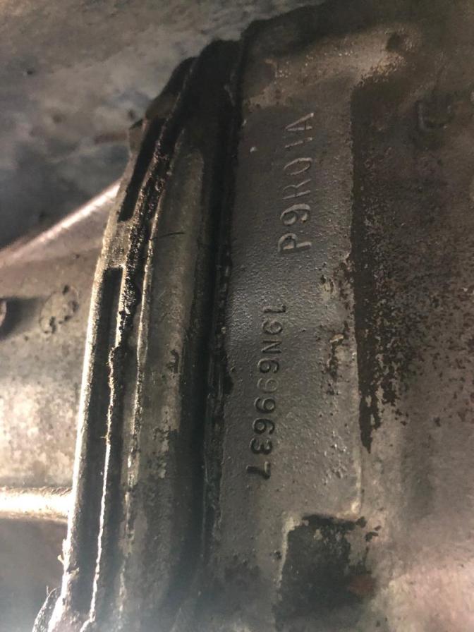

Hoping someone can decipher this tranny stamp? Friend of mine has it and says he isn't sure what it is from??
Any help appreciated
Mike

P9RO1A
1969
OCTOBER
1ST day
M20 transmission
i believe this is what you have
thx
chris
1970 citrus Yenko Nova

Thanks Chris. I guess I should have indicated I'm trying to figure out what brand car by virtue of the vin font and style. Camaro. Chevelle. Prius

69 Camaro. Specifically a N (Norwood, Ohio) built car

Partial vin starts with 1 for Chevrolet 9 for 1969 Norwood 1969 Camaro

Is the trans from a Z28

there is no way to tell

----Being an M20 I would think it odd that the trans might have come in a Z!......Bill S
I just sold a complete 69 z28 numbers matching DZ motor with Vin matched M20 muncie.
