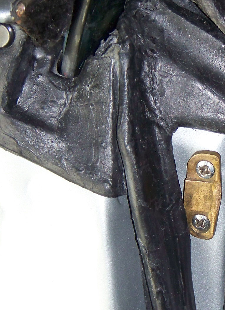

AS AN ASIDE... these are originals which were re-dipped into black latex and then cured out in the oven at 175 deg, after curing I sprayed them with mold release agent and installed, still on the car up at Rick Hendrick's after 4 years.
