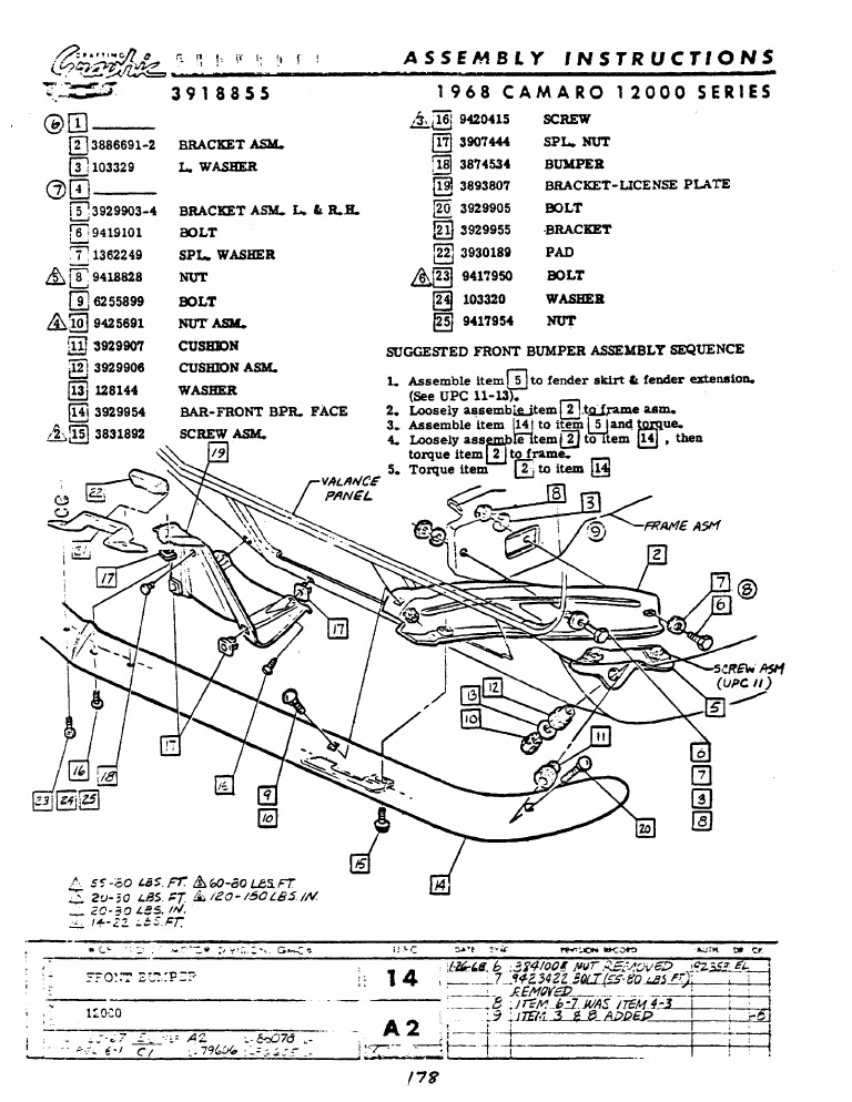

Could anyone send pics and or a description of the way the 1968 only bracket shown in the picture (mounts inside the bumper). Is this bracket/bumper mounted with a nut/bolt/washer? Doing a nut and bolt resto, so would love bolt headmarkings, bolt length, washer type, etc of original equipment. Thanks all.

My car is being stored elsewhere, but I'll see it this weekend and I can send you pics then.
The bracket is bolted to the bumper, but the bumper has to be a 68 bumper with the three holes in the center. The bracket bolts to the two outer bolt holes with a bolt / nut. If I remember correctly it was 5/16 bolt with the head marking of "R S C" and was like 1" long. The bracket once bolted to the bumper has the rubber stopper facing the lower valance.

Thanks Dave, yes we have correct bumper with the three holes, just need a heads up on the hardware.

Hope this helps.
