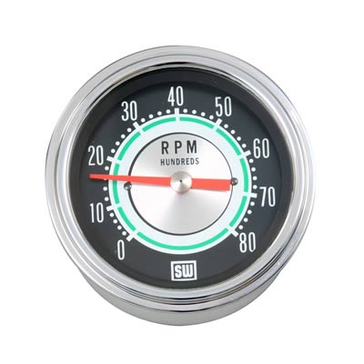

How or do the new greenline gauges differ from vintage late 60's gauges? Also what about the Deluxe line, same question. I'm asking about the 2 1/16 and 2 5/8 oil pressure and water temperature. Did the Yenkos use mechanical or electric gauges? Thanks

These are the repro's, they have obvious differences to the originals - JoeB prob has plenty of NOS one he can post pics of....

Just bought a bunch of Greenline SW's for a boat resto I'm closing in on. They may not be exactly the same but do seem a very period design...….Bill S

I looked at those a couple years ago and I still like them. Just ordered a set of those.

As far as I know, Yenko only used mechanical SW gauges. As with anything, if you're super fussy and are determined to find differences between old and new I'm sure you can... but I personally think they did a pretty good job with the new ones.

Both 2 1/16" and 2 5/8" were used. In 69 they installed these 2 1/16" pre-packaged triple gauge assemblies in many cars. Dixco Hustlers on the bottom as used in '70 in the Deuces.
