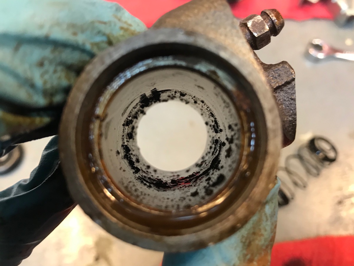

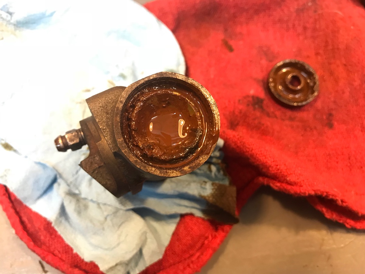

Robert. You might want to consider doing these yourself. I did mine recently and they were fairly straightforward. As long as you can get away with a hone and not have to re-sleeve them you should be able to do it yourself. I purchased the rebuild kits from the local auto parts store - you are looking for a 15/16 inch bore, by the way. Total cost for kits and honing tool was less than $25. You can see from the pictures below what I started with…

Like Sam said, do it yourself. I went to Napa to get my kits and did mine, very easy and I even honed mine out a little. Soaked them in evaporust to clean them up also.
