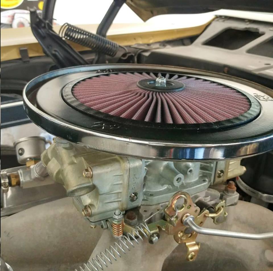

Do you know if that foam fire resistant? I had the same flat-top velocity stacks on my car and swapped them out for the velocity stacks with the air cleaners on top as the fear of fire got the best of me, but I'd like to put the old flat ones back on it sometime if I can find something that is flame/fire resistant.
