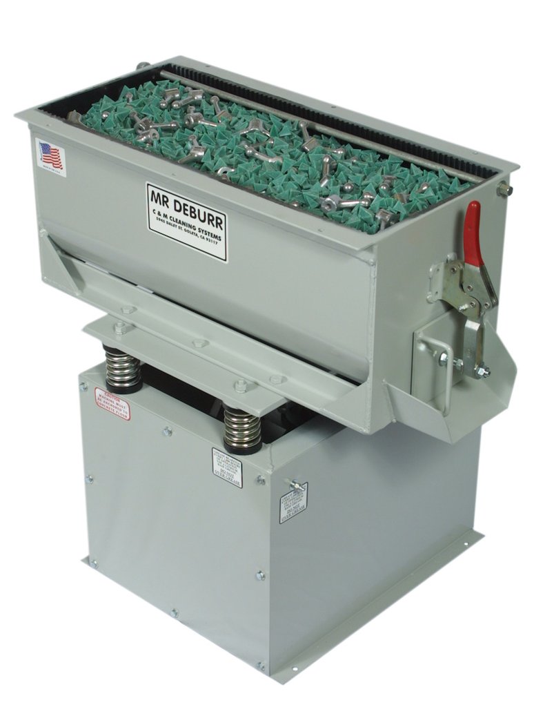

Rick, In another thread you, I and others were discussing cleaning parts in general.
Ive had all kinds of the other chassis parts, eng brkts etc etc....run through a local
shot blasting machine. What with all the massive shop time you charge customers
to stand in front of your slow glass beading machine, you need to take most of your other steel parts to the shot blaster assuming the cost is acceptable.
My shot blast guy also has a enclosed basket that I place fasteners into and then
shot blast. Ready to replate or you could quickly run thru your glass beader
Ive also bought a used MrDeBur shaker/vibrator which is another option to clean
restore metal finishes.

Rick....You had earlier stated " We spend hours a day at the glass bead cabinet for things like spindles, steering arms, brackets, clips, etc and it is a complete waste of time when I could be having a machine do it automatically for me while we do something more constructive. The expense does not really bother me as that could be paid for in less than a week in saved production time alone."
I certainly didnt mean to imply you were overcharging anybody. I was suggesting that shot blasting and vibratory tumbling/shaking would cut down on your labor hours and increase your shop productivity.
