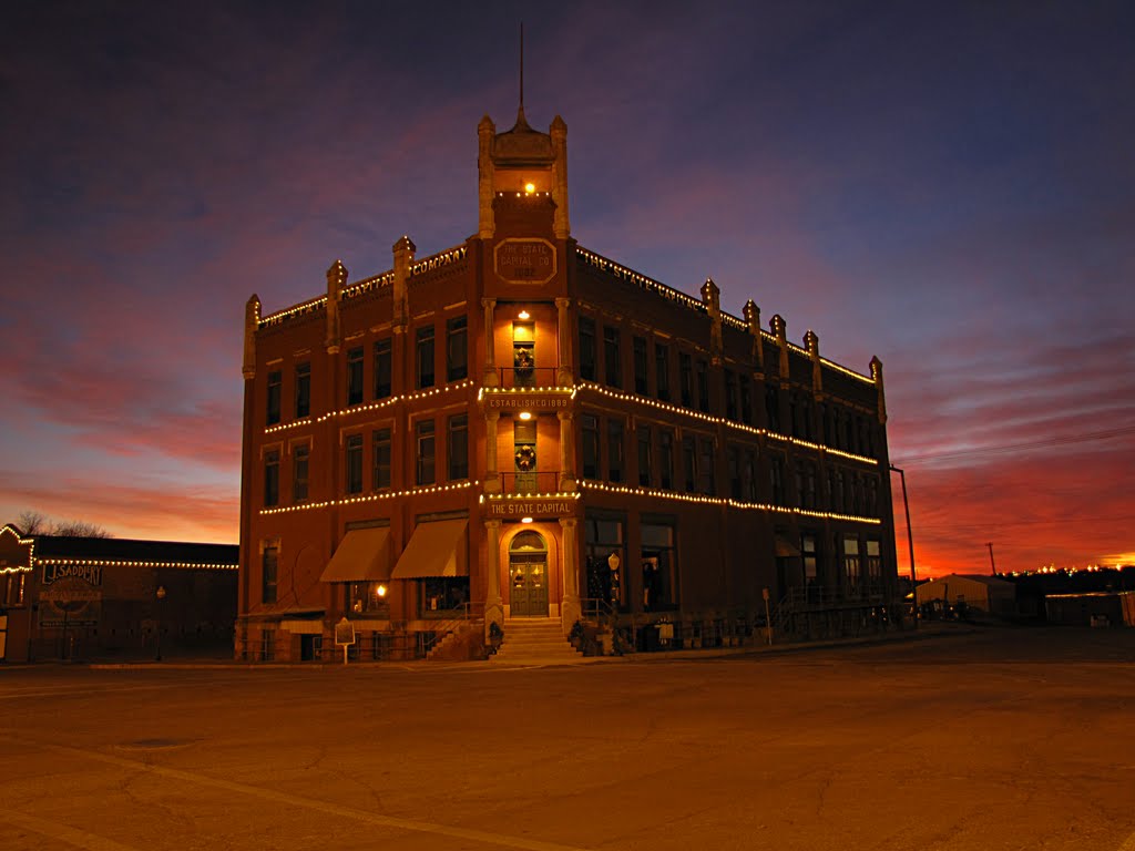

Next up, I have shared a little bit about the Publishing Museum building we are restoring. We are making progress, but I was out for a couple months, so not as far along as I had hoped. The lights are always off, and we wanted to get all four balconies lit up, so it wouldn't look so desolate at night. Sherri and I spent a couple hours with the fellow that was the curator there 30 years ago trying to figure out how to get the balconies lit. After about an hour and a half, he remembered having an electrician wire in a mercury switch. We found it, bypassed it, and voila, we have all the balconies lit. I will post a pic one day this week. Attaching my favorite pic of the building. Taken some time after 1994, but not sure when. That is our home in the back ground on the left. Gonna have to raise about $4million to get this building where I want it. My first foray into the non profit world. Fun so far.

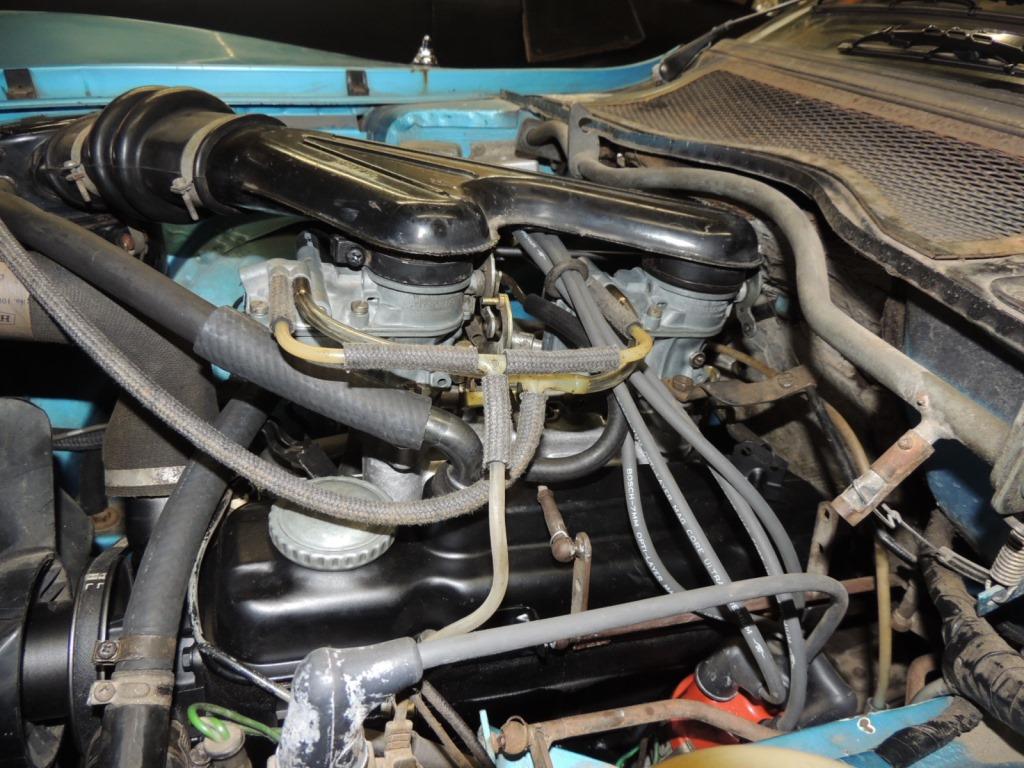

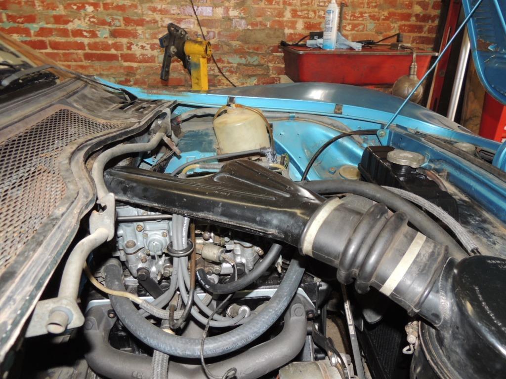

Hells bells, I am on such a roll, why stop? I started the little Opel GT on friday. First time it ran since 1974. I noticed a little seepage of water on the pass side from the head. Crap; maybe I should have used a thicker head gasket or used some sealer. Well, pulled the carbs and intake today, along with the valve cover and retorqued the head. Book says 35 ft. lbs. I took a chance and torqued to 45. I know some guys that put 45 on hose clamps... you know who you are... surely these head bolts can take 45, right?. Put it back together, and started it up. Running a straight pipe right now, as I am waiting on the muffler (found one in Italy... so it could be a while. The twin one barrels had been sitting for 34 years when I disassembled them and rebuilt them last year. I checked all the measurements twice and had to do very little adjusting. Sounds like I am bragging (maybe I am a little bit) but the ONLY adjustments I made after setting the timing (put it at about 8 degrees advanced for initial) was to screw in the main idle valve, then set the mixture screws. Only had to move the mixture screws about 1/4 turn in each. Have to wait until the exhaust is all together to fine tune it. I welded in an O2 sensor bung, so I could hook up an AFR meter and see exactly where things are. Will play with tuning later to get max mpg.

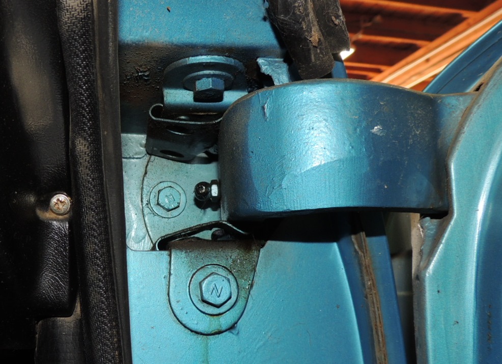

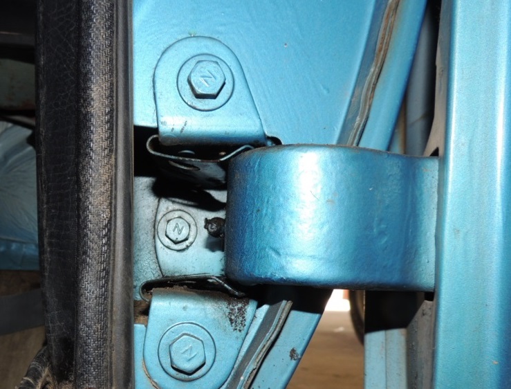

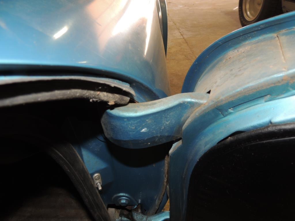

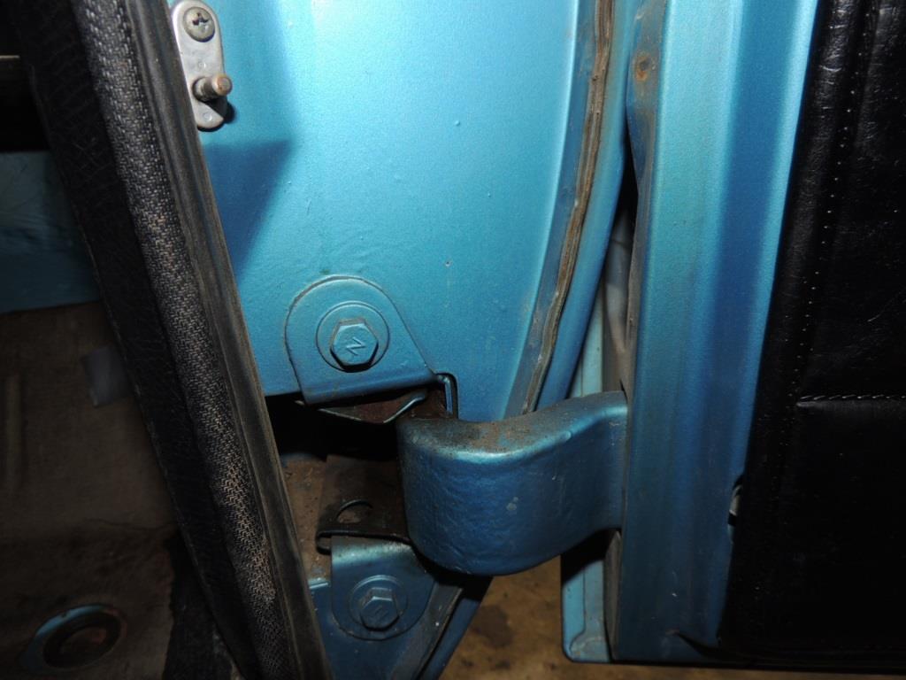

Set the toe on the front tires. Not sure why, but the toe in on this car when I got it was like 4 inches out. Don't know what the P.O had been doing. I had taken the rack and pinion apart last year, cleaned and lubed and put new boots on but waited til the engine was in before setting it. Took it for its first ride since 1974. Wow, is this little car tight. Drives like it did on 1969. I kept the 13 inch wheels, and found some 165 x 13 radial tires for it. Still has the Delco spiral shocks, and I was surprised, none leak and all are still pretty stiff. I took it to the gas station (also had a couple gallons of that 100LL in the Opel) and put another 6 gallons of premium (no ethanol) gas in it. Was so excited about how well it drove, I installed the passenger seat so I could take Sherri for a ride. She was really surprised at the ride quality. She couldn't believe how well the doors open and shut. I have not made any adjustments on the doors. There is zero sag. I am posting pics of the massive hinges along with the factory grease zerks that are easy to get to. This is how door hinges should be made.

That building is great!!
