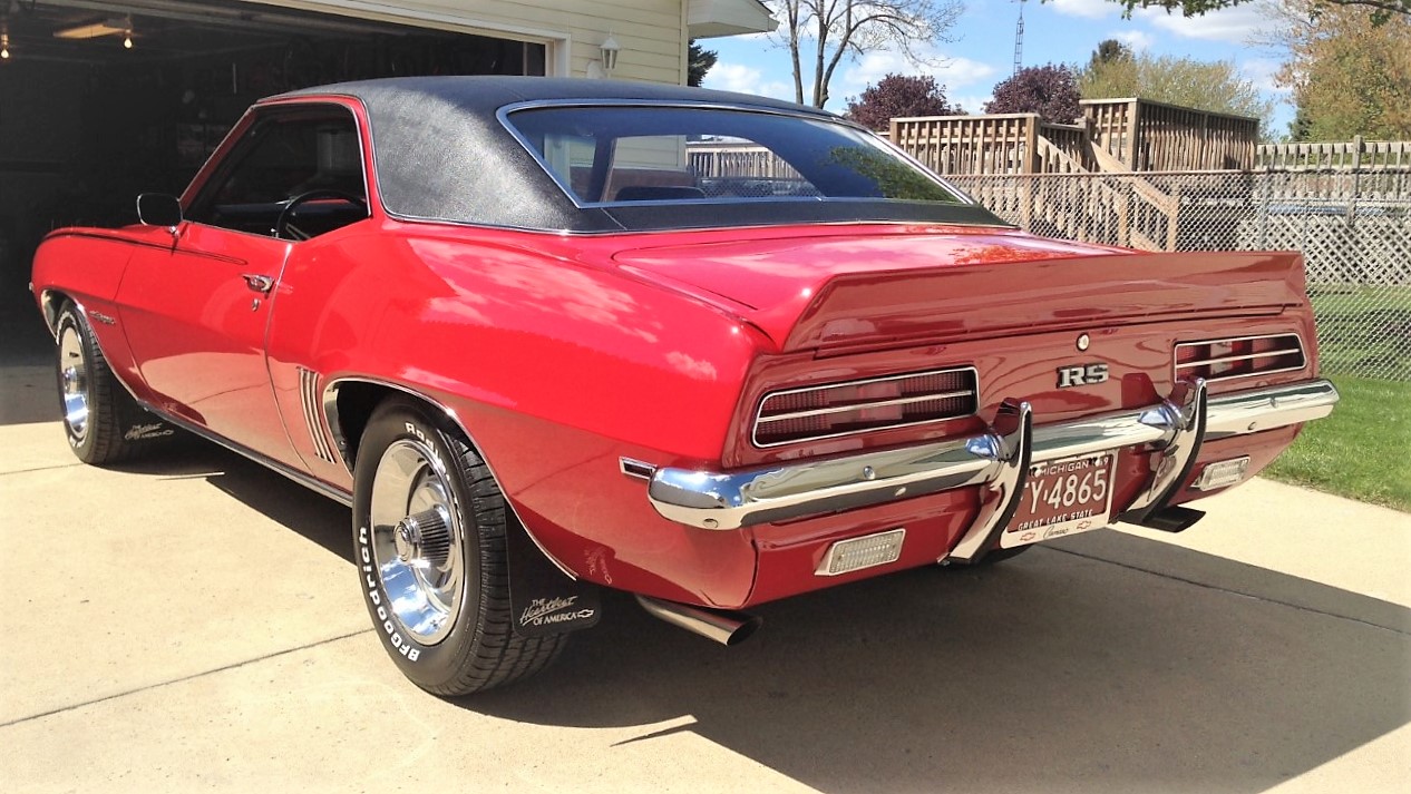

Ken, I bought a set of assembly line/factory correct multi-leaf springs for my 69 Camaro from Heartbeat city. In my opinion they were worth the cost.

Ok, Thanks everybody for your help. I think I will go ahead and order a set , very good feedback. Tiger your car looks awesome, sits good too, not to high.
