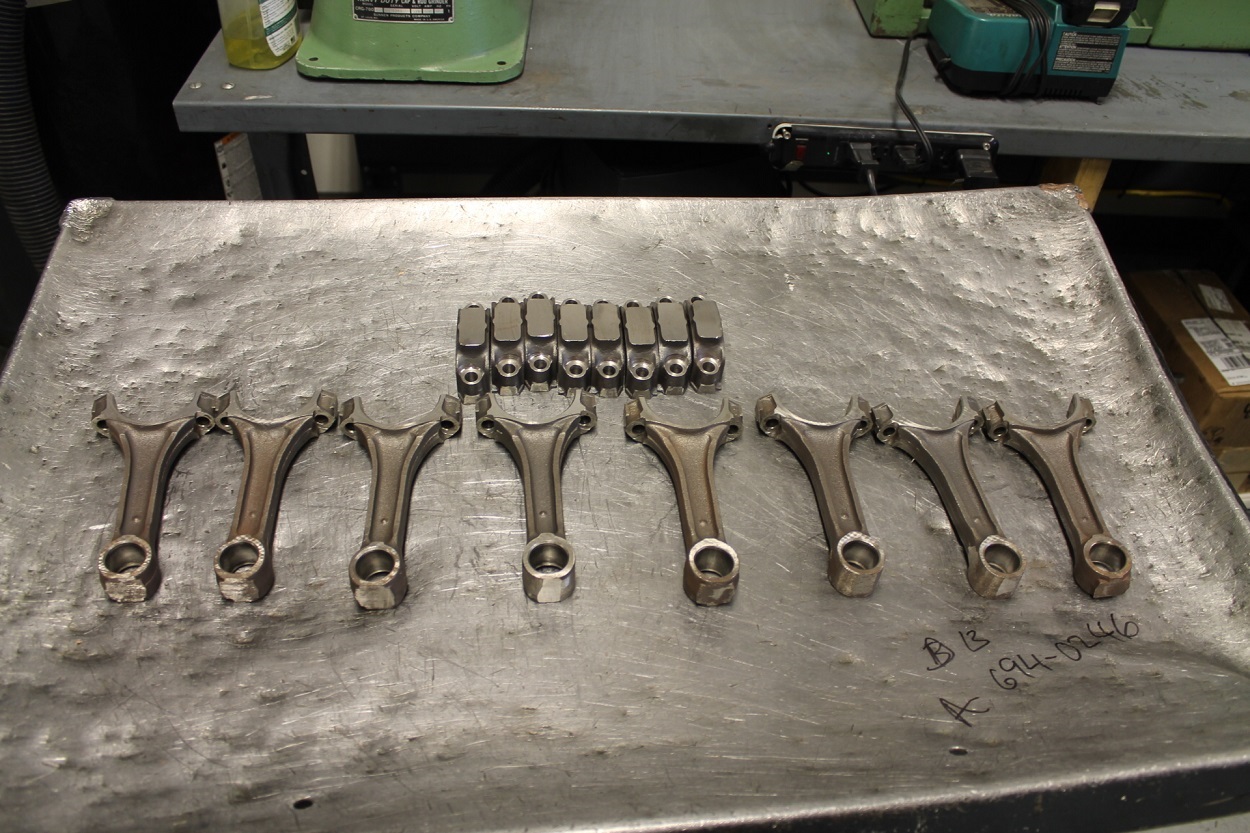

Connecting rods were wet magged, length set, small ends checked for press, then finally resized, then balanced.
