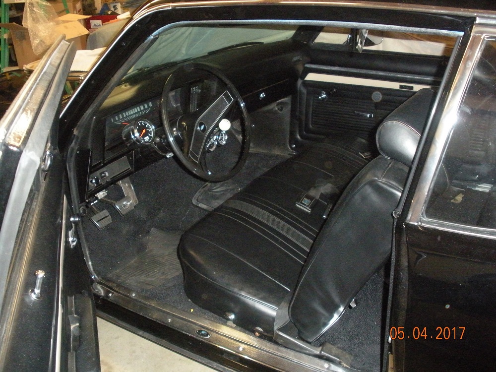

It fits nice and looks stock. I am actually changing it out because I want more of a day 2 look but it doesn't hit anywhere on the dash or seat and is comfortable to drive. Here are a couple pictures, not the greatest but hope it helps.
