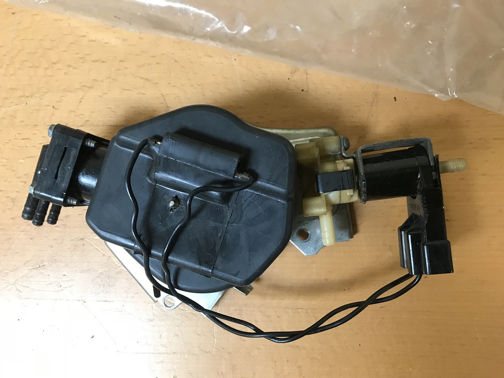

I've never seen one with the solenoid. Is this 68 SS427 Impala?

That solenoid looks like the same one used when a car had headlight washers...Joe

Could this be a 1969 Impala with hideaway headlights and CE1 headlight Squirter option? Any help in ID'ing these is greatly appreciated. Thanks

I've seen a few of those before & I believe that's what it is.

looks like '69 Corvette with headlight washer. Corvettes used that sideways pump connection to clear the ignition shielding.
