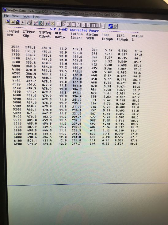

Made our first dyno run on the L78 engine for my 67 Camaro. It's bone stock carb to pan. Generated 397hp at 5,500. Was running a little lean, so re-jetting tonight and run again tomorrow. Anyone have input on what HP a stock L78 should put out?

Was the session with headers or exhaust manifolds? Ours with a little lower compression made 450 with the shops carb, headers and dist. but almost 70 less with the stock carb and distributer.

Eric did the carb. Ran on dyno with headers, stock dist and carb.

Seems impressive to me. Was max HP at 5500? Seems to me there would had been a little more runway left for more HP?

Should take roughly a 74 primary jet with headers on the dyno, will want the 71 with manifolds in the car. Secondary jetting should be good as is.

When the L78 was introduced in 1965 it was rated at 425hp...this was based on 6400 rpm's...almost 1,000 rpm lower than the engine being discussed. Most folks would agree that the later 375hp rating was low...headers, properly tuned distributor/carb and blueprinted assembly all make a huge difference.
Last one we did was a 70 402 version...pancake intake, Eric prepared 4492 and run thru headers...it made north of 430hp.
Again, the real power difference in these motors is in the details.
