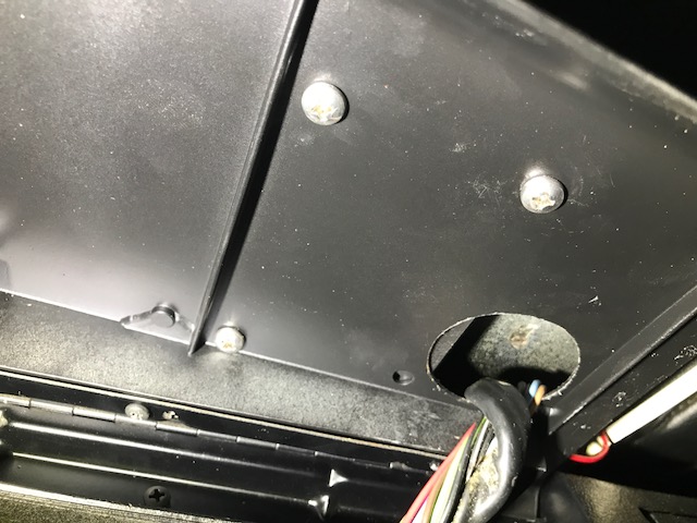

Old 07-18-2017, 02:41 AM
Location: Woodland, ca. US
Posts: 16,127
Thanks: 563
Thanked 5,473 Times in 1,327 Posts
My 68 Dana has the 8 track. I'll go take a couple pics.
Old 07-18-2017, 02:58 AM
Posts: 16,127
Thanks: 563

Here's the template, which I already emailed. The picture of the underside Charley's was not done correctly per factory instructions. I've had several cars survivor cars with 8tracks and the lids were modified per the template.
www.vintagecertification.com
