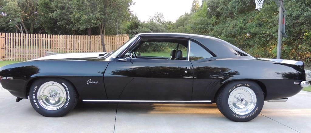

scored a new in the box set of satin old school centerline wheels for my 67 Camaro build there 15x8.5 whats a good size rear tire to run on these? tried running 15x10 they stuck out too much

Not sure what look you're going for, but I have the 15x10's with 295/50's on my '68 Camaro now, and I just don't care for the short treadwall of those tires. I'll definitely be going with a set of 15x8's with 275/60's in the future. With the manual steering and manual drum brakes, I need all the help radial tires can give me, so no plans for bias plys anytime soon.

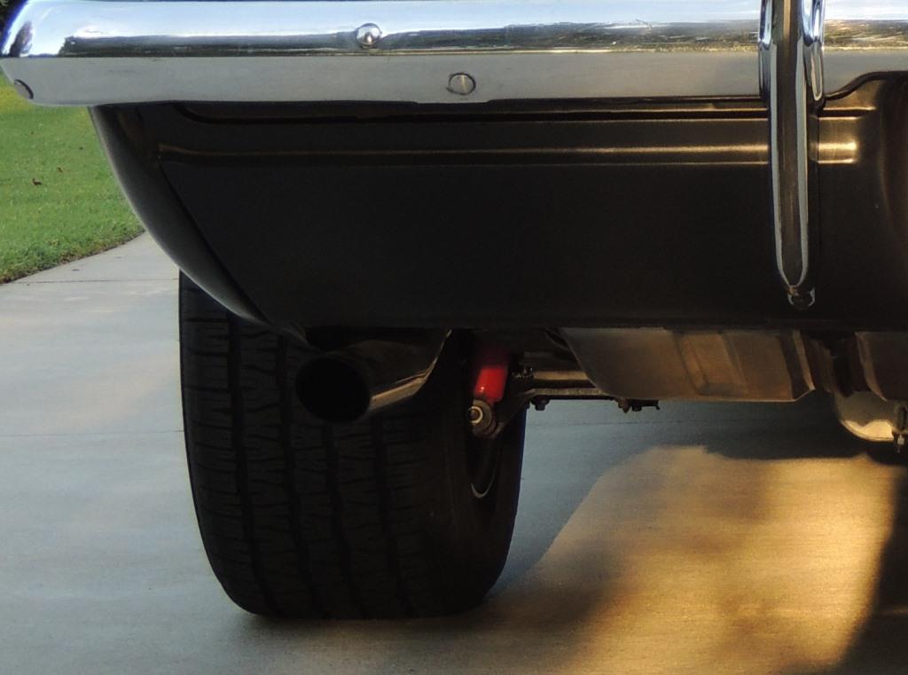

Sure.
I think 4.5, or something very close to it. I remember spending a lot of time getting what I wanted. Most of the off the shelf centerlines available were less than 4.
The YH ralley wheel is about 4.25 and is only 7 inches wide. To get the outer lip completely inside the wheel well, you have to have something over 4.25.
SOME 275 tires might fit. I wouldn't corner hard though. I had purchased a KILLER looking set of 275 Hoosiers from Eric at a very fair price, but was too scared of burning the paint. Probably would be OK for straight line. Sold them to remove the temptation. Didn't make any $$ on them, but they went to a good home. Of course a couple years later, I put some vintage Centerlines on my 68 El Camino, and 275's on a 15x10 fit great on that car.

You are probably correct on the 4-7/8. I know it is really close to the shock mount. In fact, I have since put on a pair of traction bars (got tired of spinning the tires so easily), and had to bend the shock mount on one of the lower plates to get it to clear.
