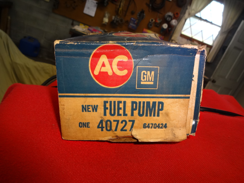

Is this the right fuel pump for a 375 hp 396?
AC 40727?

Post L78 fuel pump..
That is the one..

Correct

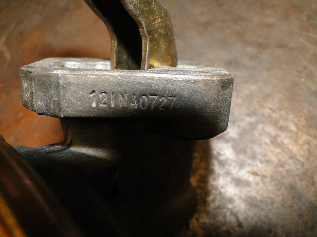

what is the date code on this pump?

Should be Sept 12th '68. (maybe)
