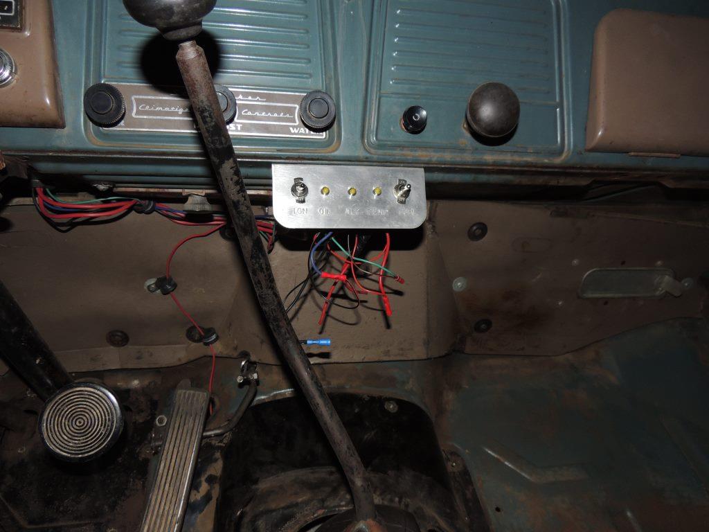

Used a control panel to run idiot lights off the engine, and for ignition and fuel pump. Wanted an electric fuel pump as it may sit a few weeks, and that way, I just turn on the fuel pump and let if fill the carb instead of cranking for 20 seconds. Also, by running thosee things separately, I can more easily split the electrical for the horn and fuel gauge which are still six volt (so they go through an adapter 12 volt to 6).
