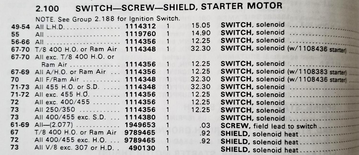

Here is the brutal Solenoid (Switch) that should be on these starter motors as shown in the MPC.
Solid steel construction. No Bakelite end as on the cheaper version.
I once owned several ‘67 GTO HO cars that had this “Switch”.
