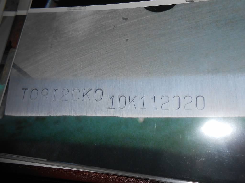

<div class="ubbcode-block"><div class="ubbcode-header">Quote:</div><div class="ubbcode-body">A local guy is selling his 1970 SS 396 Chevelle 4-speed with the L78 engine. He claims the engine is matching numbers, but the numbers look too good to factory. Not an expert by no means though. Do any of you Chevy guys think this is a legit stamping?</div></div>

I think it's odd how they stopped the milling machine in straight line to leave stamp. Is this possible?

Almost looks beveled down ...

OBVIOUS FAKE BOGUS KANSAS RE-STAMP FOR SO MANY REASONS!..and yes I'm yelling.
VIN 136370K112020 for posterity.

They are definitely getting better at it. If not for a couple of really stupid mistakes this could have gotten by most.

<div class="ubbcode-block"><div class="ubbcode-header">Originally Posted By: Billohio</div><div class="ubbcode-body">I think it's odd how they stopped the milling machine in straight line to leave stamp. Is this possible? </div></div>
With a belt sander. Lol

It may be &quot;matching numbers&quot; due to someone's overactive (but, not well executed) imagination. It just ain't original!! [img]<<GRAEMLIN_URL>>/no.gif[/img] [img]<<GRAEMLIN_URL>>/crazy.gif[/img]

----Broach marks tell the tail and they are bogus, bogus, bogus......Bill S

<div class="ubbcode-block"><div class="ubbcode-header">Originally Posted By: 69z28302</div><div class="ubbcode-body"><div class="ubbcode-block"><div class="ubbcode-header">Originally Posted By: Billohio</div><div class="ubbcode-body">I think it's odd how they stopped the milling machine in straight line to leave stamp. Is this possible? </div></div>
With a belt sander. Lol </div></div>
Yep. With the head on it might not look so obvious
