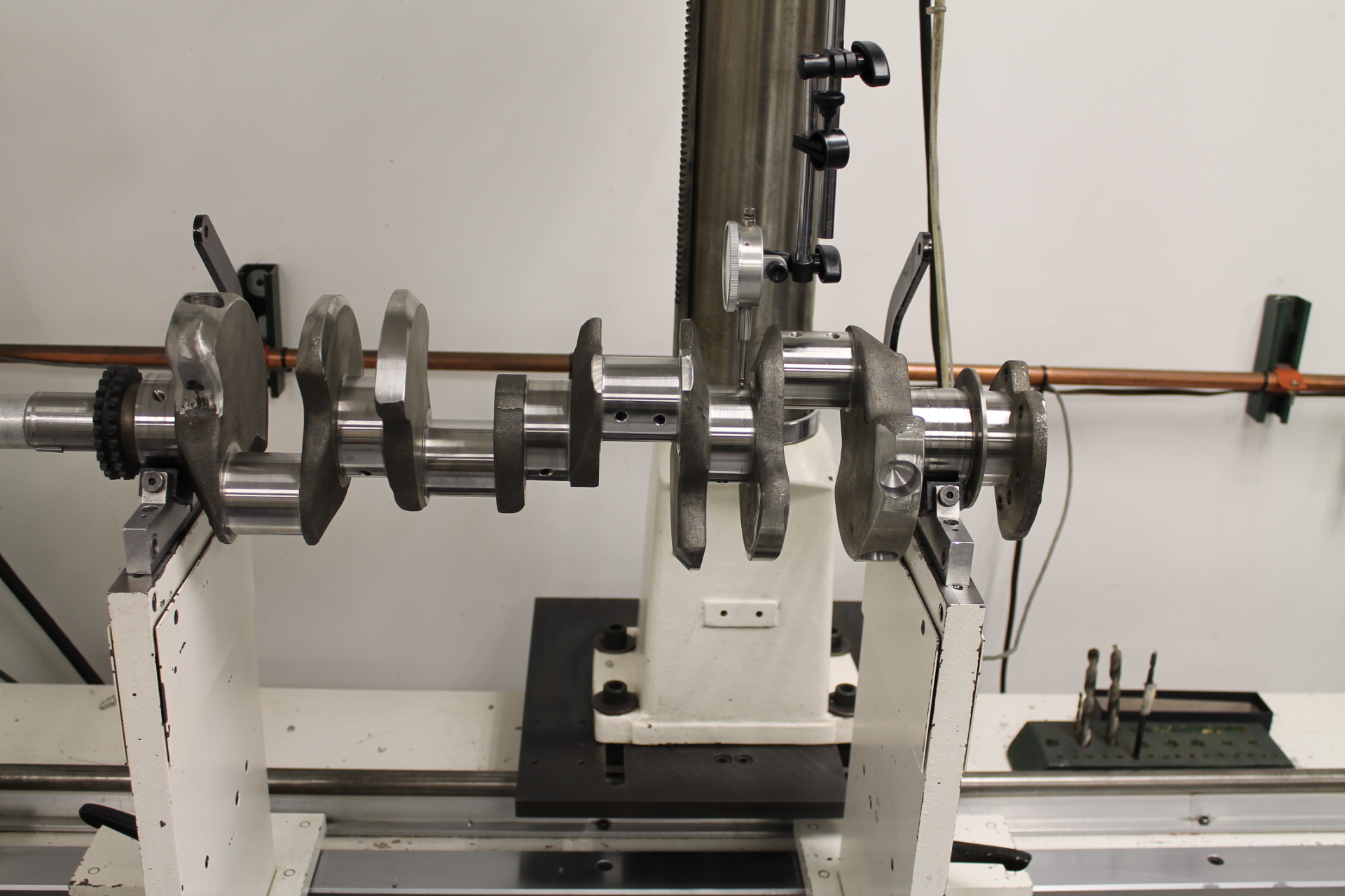

Heres you go Anders.... more pictures, the crank GM 7416
