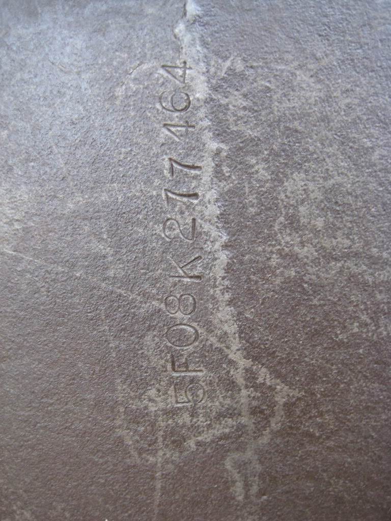

Jeff,
I have owned a few original Mustang HIPO toploader transmissions (both 65 and 66) and some of them have a partial vin stamp. Not all of them. Vin stamp was never usually in one certain place. You'd have to check over the whole unit. Here's an example of a toploader HIPO vin.
