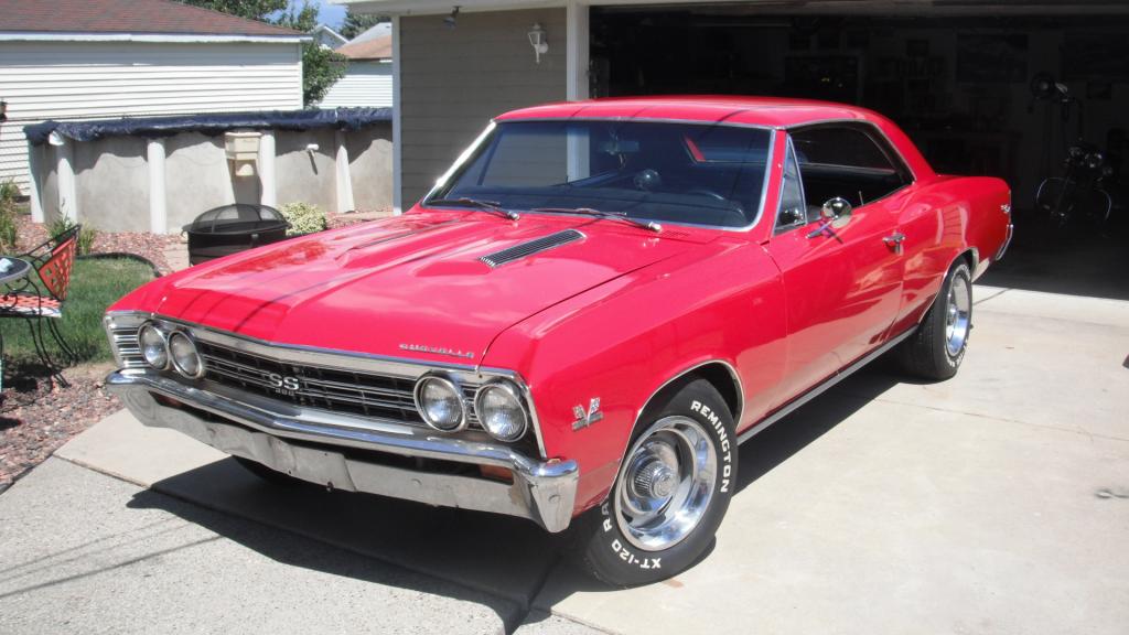

I figured it's time the Chevelle got its own topic. This one won't see many posts for a while however, since it runs just fine except for something killing its battery and it can't be driven thanks to the tires. We just got a new grille emblem and door mirror for it. Trying to persuade the dad and my Pappaw to get it the new tires it needs.

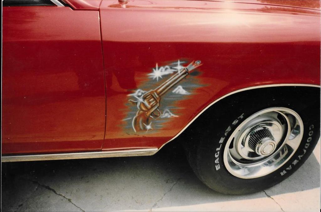

Scanned some old pictures of the mural it had. Pappaw didn't really like it (nor do I, I usually like murals, I just don't fancy this one) and as you can see it needed bodywork anyway.
