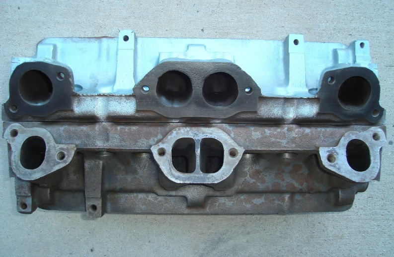

I'm not a Pontiac guy from a 1970 400... are these the oval port gaskets? They don't look like D shaped to me? I guess there was 2 style heads? I was told not to use the metal which these are what are my options? This is the passenger side the driver side is broke in two. That drivers manifold is stuffed in there that side is going to be fun to get out.

Jason, that's the standard d-port Pontiac configuration.
The d-port verbiage comes from the fact that center two exhaust ports are one large oval, but have a dividing wall, so it looks like a couple back-to-back D's (bottom).
The round port heads have 4 large exhaust ports, all separated. Those are RAII, RAIV, and SD-455 (top).

Don't forget the '71-'72 455 HO round port engines.

Awesome that is just what I was looking for. The owner drove the car into my garage and shut it off. When I got it on the lift I new it was going to need an exhaust. Well I installed a new exhaust started it up and exhaust manifold leaks both sides. I was able to drop the passenger side down to get this one out. The driver side is going to be tricky. The Z-bar is in the way of the back bolt on drivers side. The drivers side is stuffed in there. So if I had taken the manifold all the way out I would have seen that D port. Thanks for the pictures greatly appreciated.

Yes, and I forgot the 1971-1972 455 H.O.'s.
