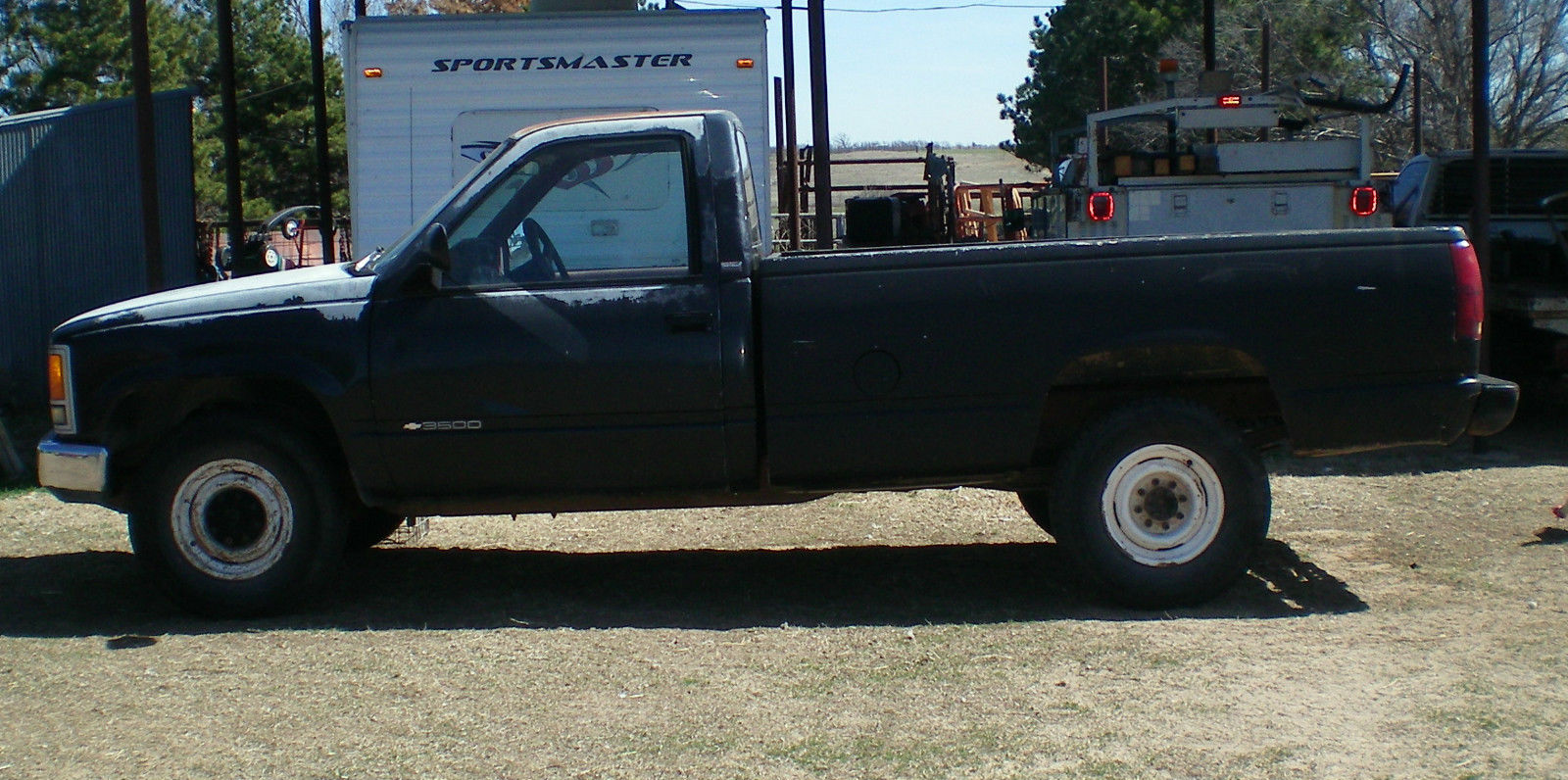

Here are pics of the potential donor (along with one of the Studebaker). It is a running, driving vehicle. I would go through the engine just because, but it already has a new clutch. Go through the brakes, get the A/C working and transplant my Studebaker cab and the dump bed (looks like a stake bed or flat bed). I have plenty of fab skills (after all I have a chop saw and two mig welders, which makes me a fabricator, right?) I know I will need to fab up some brackets and adapters to get the Studebaker stuff on the Chevy chassis.

I have a couple questions for you truck guys. As you can see, this truck has the 8 lug wheels, but not dually wheels. If I am hauling a car, I would feel better with dually wheels in back. Can I just buy a set of 4 wheels and use this full floating rear? Fender clearance won’t be an issue, because I am going flat bed. I would rather not go looking for a complete rear end.

theres 2 &quot;dually&quot; widths from what ive been told by a few yards..years ago i needed a rear..
the true truck dually and a cab and chassis dually..the cab and chassis rear is more narrow...
i dont know for sure..thats what they told me when i needed a rear...the 1 ton dually rear is wide..from what i was told..the widest rear GM made for a medium duty truck..and around here they where impossible to find
If was going to do a rear swap..id look at dodge duallys..they are dana 70s and 3.54 gears are very common in cummins powered trucks,,i had 3 of those and all 3 where 3.54 posi
matter of fact..id look at a whole dodge chassis with a cummins...they made long bed extended cabs trucks...pretty common and pretty cheap for the mid 90s trucks now..i bought 2 of those trucks for under 2 grand for the cummins swap in a GM chassis...now looking back..i should have put the chevy cab on the dodge chassis and been done with it...but then again...thats too easy and no fun...

IIRC, the axles are the same on a dually/non-dually pickup, just the wheels change. You can just bolt the wheels on and add the flares and you'd have a dually. Ford didn't sell a 4WD dually for a few years (92 or so??) and that's what you did to make one.
And I think Mark is correct that there were two widths of dually axles, pickup and cab&amp;chassis.
