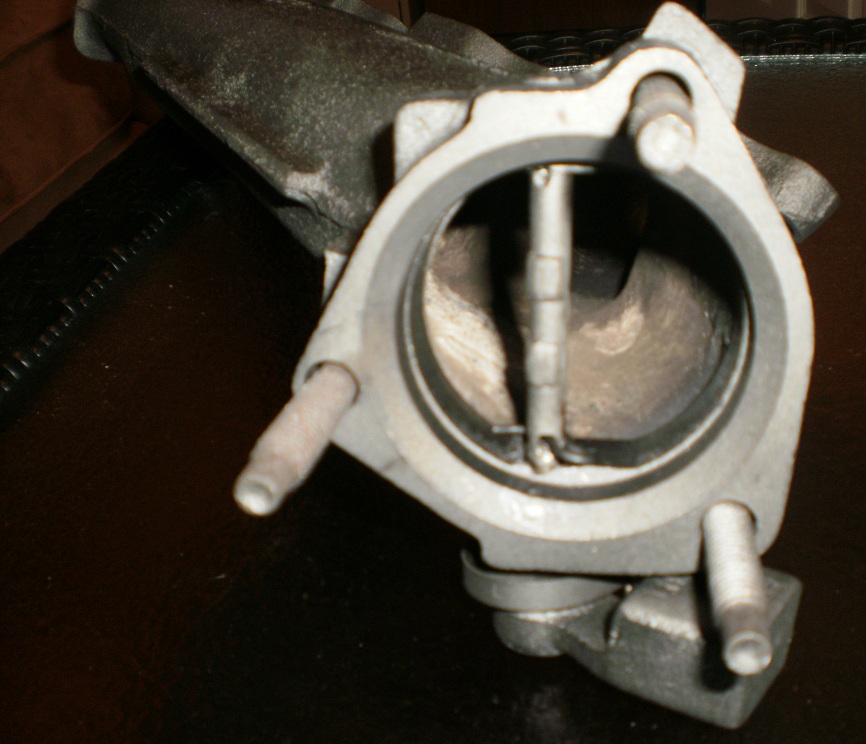

Well Dan, I like them both, &amp; since my car is
a driver not a concours resto I'll
do the &quot;paint cook&quot; approach, then consider
CCC, if my expectations are not met.
Great responses thanks.
Here's what I'm working with. You can see the rust
beginning.
DH [img]<<GRAEMLIN_URL>>/flag.gif[/img]
