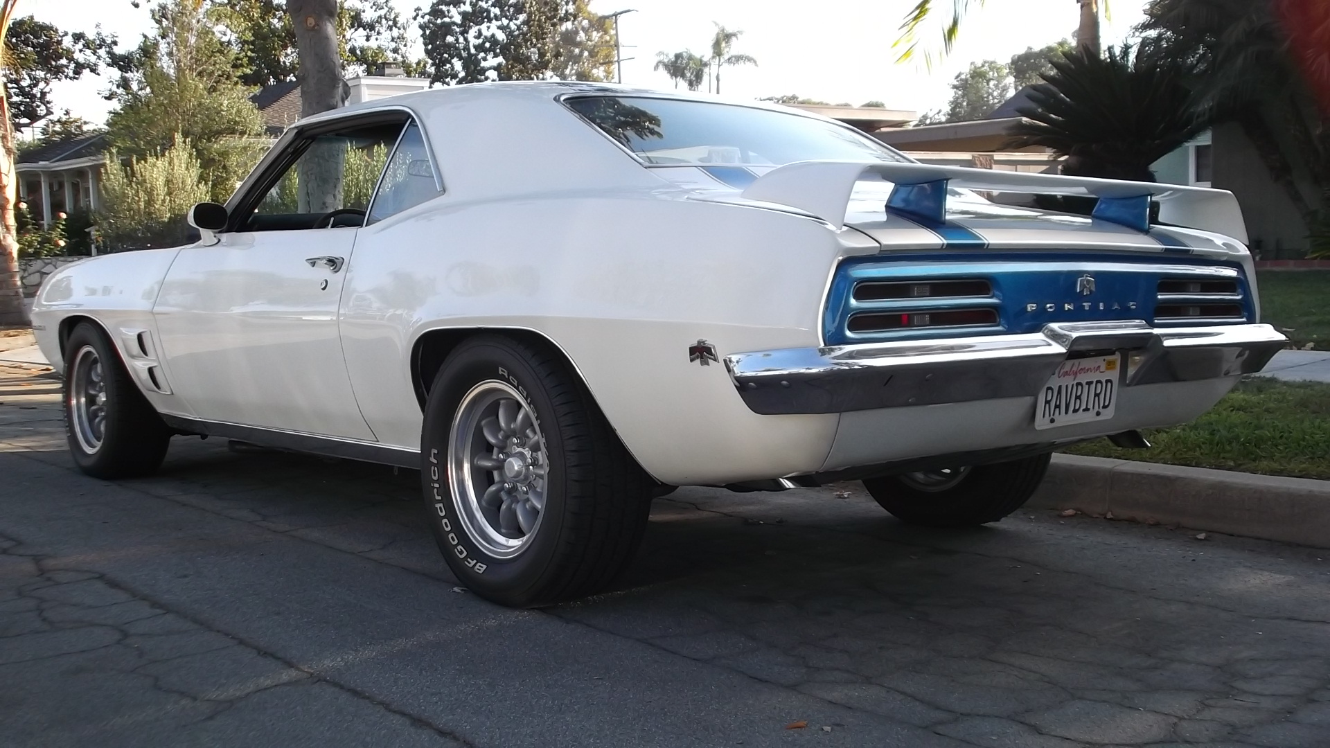

Here is a pic of the car and the engine installed.Tom
