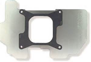

Default Carburetor Heat Shield
Was there ever a performance engine on any model of
Chevrolet that got the Heat Shield from the factory???
Were they all over the parts counter???
Thanks, Dicky [img]<<GRAEMLIN_URL>>/flag.gif[/img]
Dicky

Default Re: Carburetor Heat Shield
They weren't only available OTC.
It started out as an RPO on 1970 vehicles sold brand new in the state of Calif.,parts of Nevada and a few other low lying areas in the southwest equipped with the GM regular production option <span style="font-weight: bold">NA-9</span>....aka EEC~(Evaporative Emission Control)..aka Charcoal Canister.
This was not part of the A.I.R. SMOG equipment as some say.
They do work great if you have a 70 L78 or LS6 with the 569 (flat) intake, helps keeps the hot intake from boiling the fuel in the Holley fuel bowls
Dicky.....not sure of other year Camaros but the 1970 Z28 with Calf emissions RPO NA9 came from the factory with a unique heat shield that was very different than the one you have pictured. I'll post a pic of one below.
Thank you Randy &amp; Rick.
That is an odd looking shield. So it is my understanding that
it did not matter where the car was built (NOR or LOS) it
depended on where the car (70 Camaro) was being shipped to, (Calif.)
I hope my car will accept the 3969835.(70 LT-1)
