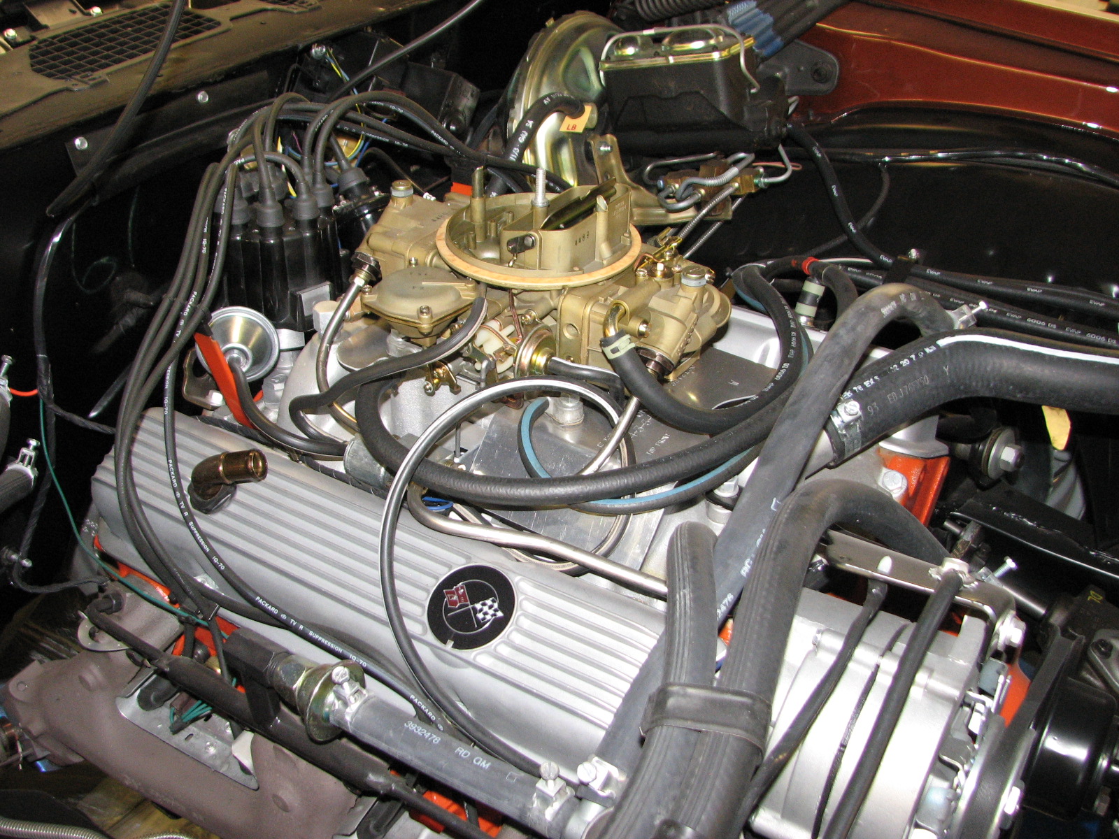

Dicky.....not sure of other year Camaros but the 1970 Z28 with Calf emissions RPO NA9 came from the factory with a unique heat shield that was very different than the one you have pictured. I'll post a pic of one below.
1970Camaro Z28
Old 05-19-2014, 06:44 PM
Posts: 10,386
Thanks: 3,297
Thanked 4,866 Times in 1,190 Posts
Default Re: Carburetor Heat Shield
What it looks like installed complete with NA9 system.
