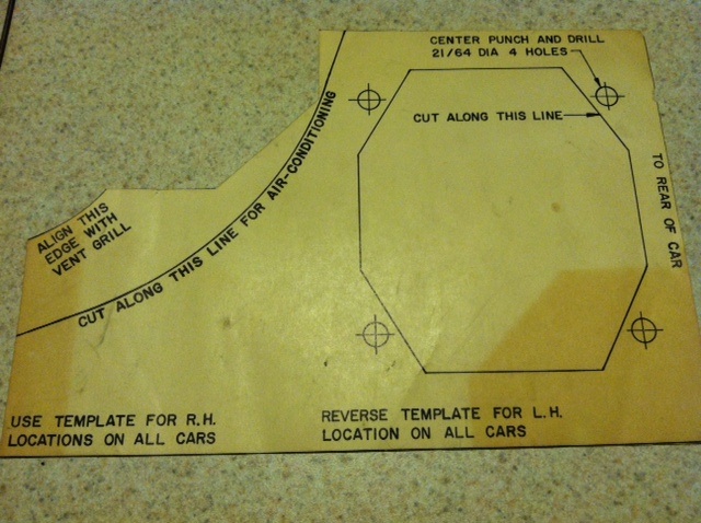

Posts: 3,350
Thanks: 60
Thanked 92 Times in 44 Posts
Default Re: Kick panel speaker grill question.
The cutouts measure 4-1/8&quot; x 4-7/8&quot; , mitered corners are 7/8&quot; x 1-1/2&quot;. The hole spacing matches your grills @ 3-3/4&quot; x 3-3/4&quot;. The only noticable difference in the templates is a 7/8 difference in height from the bottom up. Both measure 1&quot; from the A/C line or 3-3/4&quot; from the vent grill.
