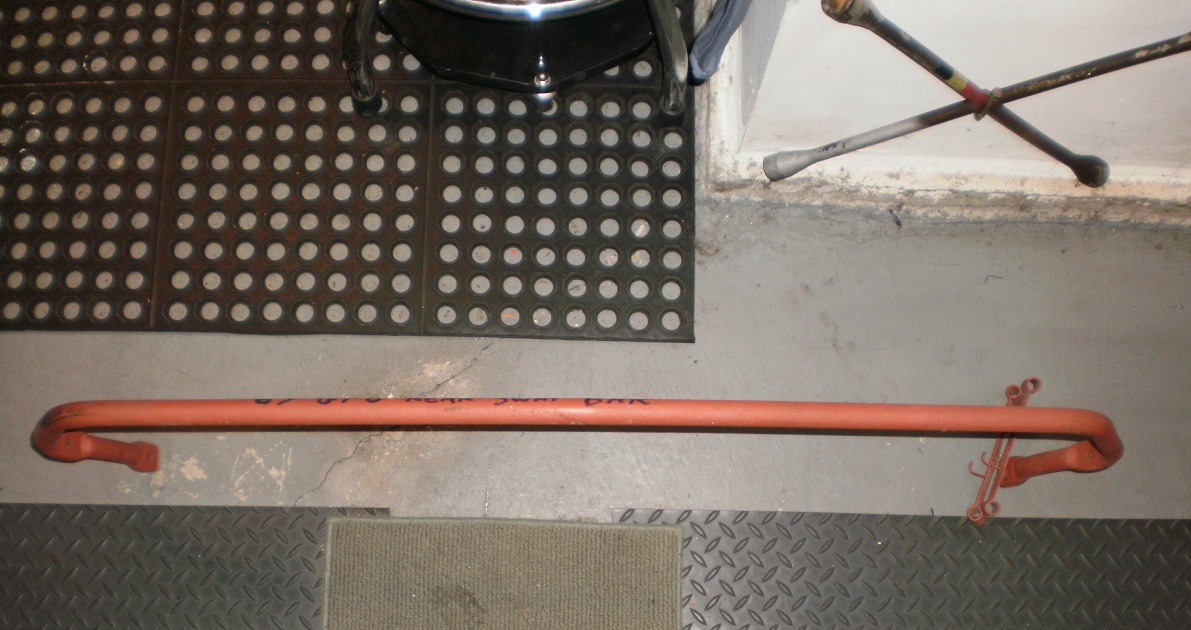

Marked GTO but pretty sure it is in correctly marked.
Has a slight curve in the center laying flat on the ground but does not dip in the center like a GTO sway bar.
See photos and let me know what you think [img]<<GRAEMLIN_URL>>/hmmm.gif[/img]
From back to back 37&quot;
From biggest curve points 41&quot;
From front curve to curve 34&quot;

Looks like the ones used on 78-81 Malibu with f 41

Thanks Scuncio,
Your respond paved the way for me.
F41 1978-1988 Monte Carlo SS, Cutlass, Regal, Grand Prix and 1978 to 1983 Malibu. [img]<<GRAEMLIN_URL>>/biggthumpup.gif[/img]
