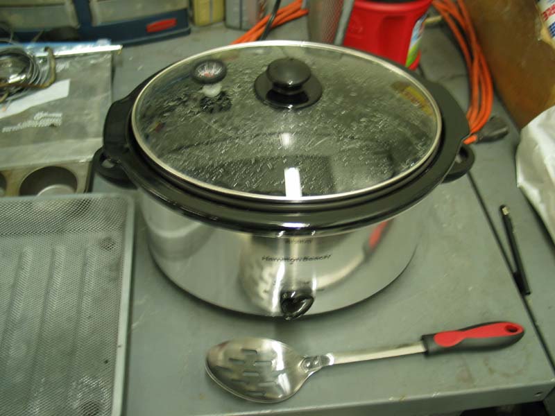

Bought some parkerizing fluid to do phosphate coating. Kind of cold out in the garage, and besides I don't have a hot plate.
Does this stuff put off any kind of offensive odor?
