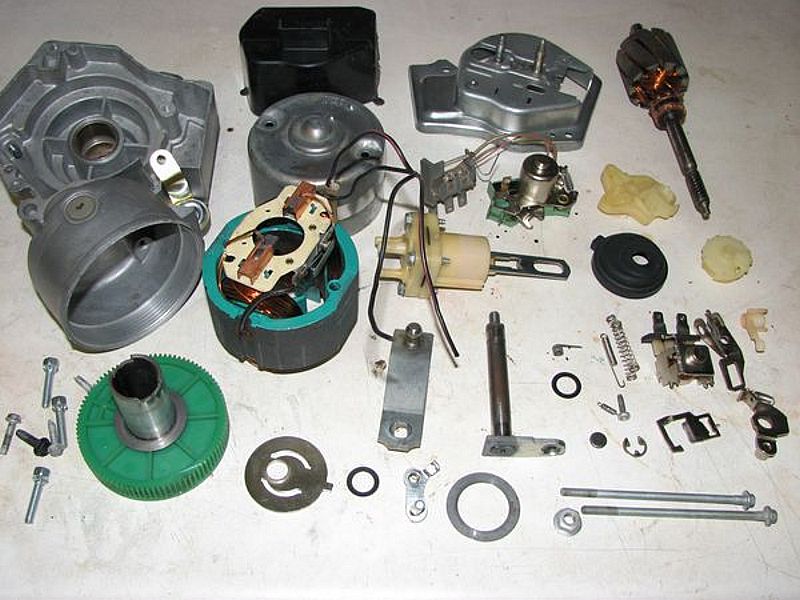

I picked up this really nice GM#5044756 Original Wiper Motor from a 1971 Chevelle SS, trying to find out what the part is called that has the two connectors coming out of the black plastic cover that is part of this unit.
I will need to replace it as the wire connectors are snapped right off this unit. See Photo.
If anyone knows the proper name of this part or can come up with a part number it would be much appreciated.

That's the windshield washer pump terminals.

I would simply replace it with one from a donor unit. They can be had for virtually nothing and I don't recall ever seeing one of these solenoids being sold new. They are a little tricky to remove and replace but can be done with no problems. Much care has to be taken when bending the metal tabs underneath the face plate but it can be done. I do this on every frame off restoration we do.

Thanks guys,
It was no problem at all taking it off and should be easy to replace.
I think that is a great idea to buy a beat up wiper motor at a swap meet just to get that part as i probably can not buy one on it's own.

I did a Google Search on "Windshield washer pump terminals" Thanks to MR70 and came up with the correct name and part number for the part, it is called a "Washer Pump Magnet W/Terminals" part number 10.150 then i tried finding one for sale on it's own and no luck so time to buy a donor Wiper Motor.

For 50 bucks you can pick up a whole new GM washer pump unit and the solenoid is included.
