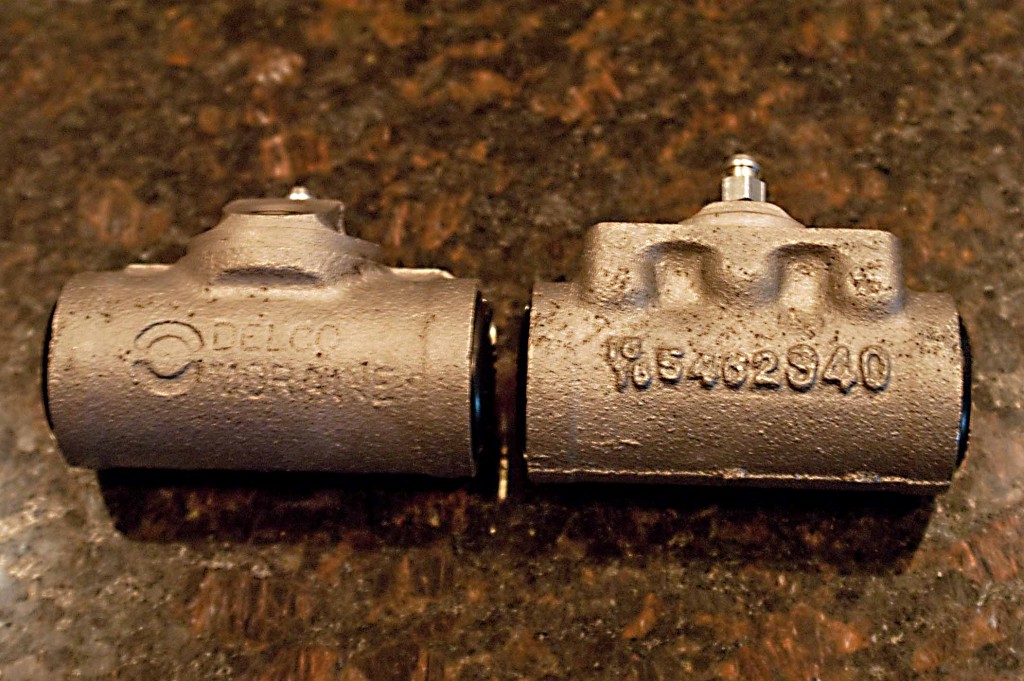

Look what arrived today! Karp's sleeved them (with stainless)and rebuilt them. I circled the date code, but I can't make out what the characters are.
