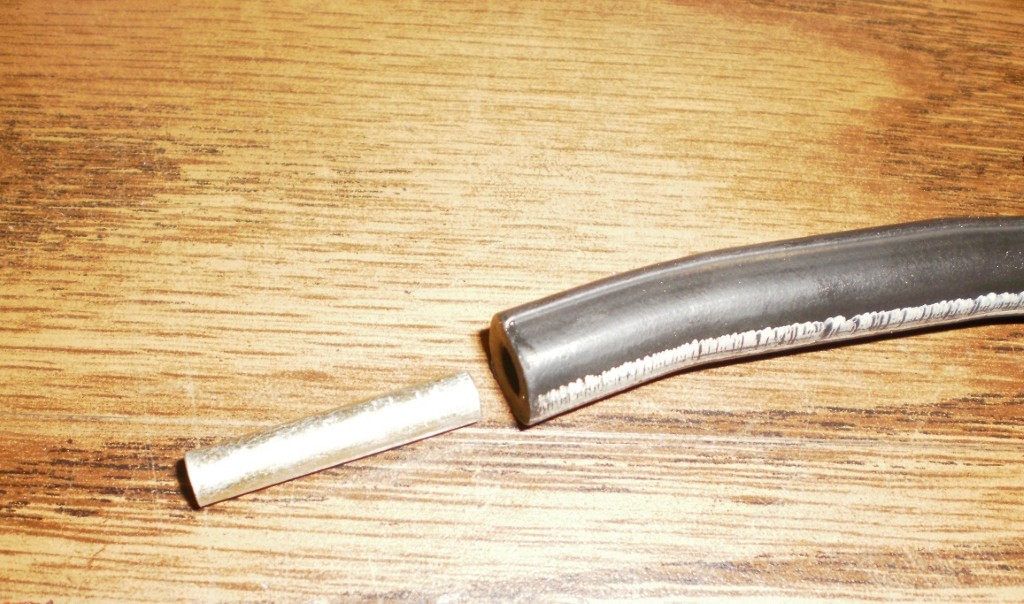

I was wondering what you guys have done with your smog system on your Big Block Chevy's.
My friend has a 1969 Z-28 and he told me to de-gut the smog pump and plug the holes with roofing nails under the tubes on the manifold for better performance which he did to his own car.
I am currently putting together the entire Smog system for my LS6 454 and just wanted your opinions if i should just run it normally or de-gut and plug.

Here is a pre assembly photo of the work i did this morning.
Just wanted to make sure everything fit right.
Will wait till motor gets back to do a final installation, meanwhile more opinions neaded if i should run it like stock or de-gut and plug.
I went through Google to see what i can read up on this subject and really not much luck on finding threads about de-gutting and plugging the smog,but i did find threads about how the system works and it really only robs about 1 or 2 horsepower and ads weight.

At least 90% of the cars I restore have non working smog pumps on them. It has nothing to do with robbing horsepower but has everything to do with heat and moisture in the asperator tubes which will discolor and rust them out. On some cars I machine non smog manifolds to accept the asperator tubes but do not drill them completely through so there is no need to plug them.
