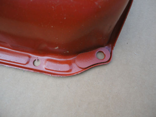

I am looking for information about ORIGINAL assembly line installed oil pans for 1967-1974 Z28 Camaros. If you have detailed pictures of a known to be original pan for one of these year camaros, can you please post it? I kind of want to start a reference post.

I'll see if I can dif up pics. The later pans had a larger radius opening for front seal and only two step drop. The orig had the smaller radius and three steps drop. Pictures are really needed to show the points I'm trying to make.

Here's some nice pix I saved recently.Notice the date on the box.

More..
